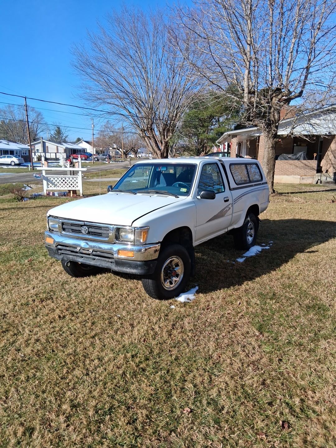

I’ve only got the one my buddy sent me. I’ve been looking for another toyota so it was bought sight unseen hahaha.

Good Was up bc my buddy was going through it. I’ll buy another grill and front bumper in black.

Looks good enough for the girls I go out with!!! Looks to be in decent enough shape, just have to dial it in!!
