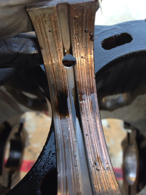

So got a few things done today. Tore the 94 block down and I'm thinking it has never been rebuilt but not sure. The bore measure 91.8 or 9 mm. But I have a cheap set of calipers. And I will put some pic of the crank and the wear.
First rebuild so I'm not sure what I'm looking at. But everything seem to measure stock. Just hope that the crank can be ground down to get back to smooth. All the bearing were starting to wear but I guess that to be expected in an engine that has 191k on it.
The block was reprinted a blue color so I assumed it had been rebuild but still not sure the piston all r aisin piston so who know.
The bore looks all smooth but I don't have the tools to measure to see if their is any misshaping to it.
Figured I would rebuild it and add all my 86 stuff back to it.
Most of the bearing look kinda like this maybe not as bad

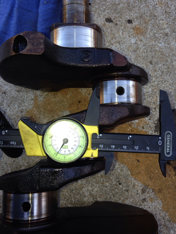

Measure just under 92 mm
Rod journal measure 2.08 or so

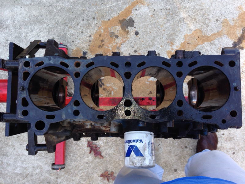

All the bore look clean no scatches

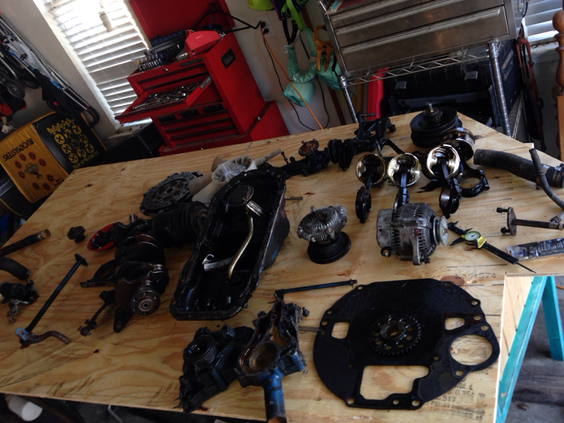

All the parts to be cleaned and reprinted

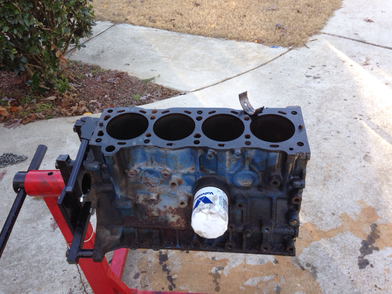

And finally the poor runner to be revived

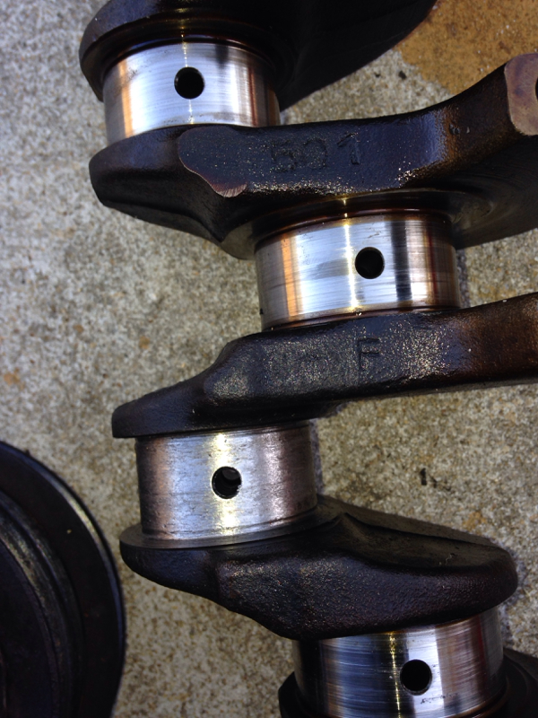

This cam bear was toast. Wasn't much left in the journal so hoping it can be fixed
