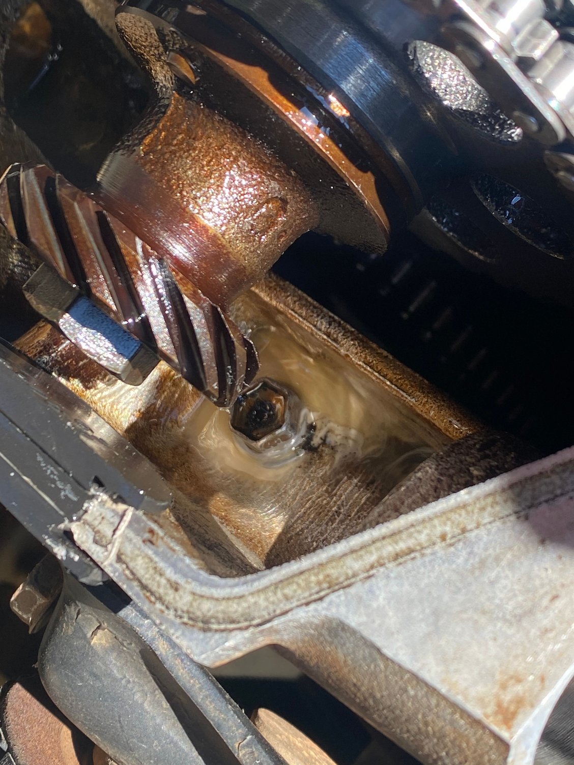

I took the valve cover off to inspect the top end and saw a little bit of milky oil but ONLY at the front end of the engine, almost located exclusively around the hidden bolt on top of the timing cover. I went and re-RTVd that top bolt and let it sit overnight. Any thoughts?
I opted for replacing the oil pump, water pump and timing cover while doing the timing chain job. All components in that area are new. I used an OEM head gasket and new head bolts. Let me know what you all think!

For peace of mind you can pressure test the cooling system and see if it bleeds down, but I'd suspect that might just be residual. I'd clean up and just monitor fluid levels. Maybe do a oil change soon.
The parts stores usually have a pressure tester in their loaner tool program.

I値l definitely have to pressure test it. I知 assuming pressure test the cooling system with the head off so I can inspect everything (ie bubbles, leaking noise, etc?)
I知 somewhat relieved as the milky oil was only on top of the head and around the first two rocker arms, essentially all isolated in the same place. If I had pressure washed the engine bay aggressively I would even assume that water got it somehow some way (but this isn稚 the case). Very odd indeed.
Does that top timing cover bolt even touch a coolant passage? I知 trying to visualize the cover itself and what this bolt is near. I don稚 think it痴 near coolant?

You can leave the valve cover on. If you do the test and have a drop then you can dig deeper. That bolt doesn’t go near a water jacket that I’m aware of.

I'd pressure test. Than block test. If it passes both I'd do an oil change and monitor. Is the underside of the oil cap clean? Having that look like a malted milkshake was always the sign of bigger issues on the 22R#.
