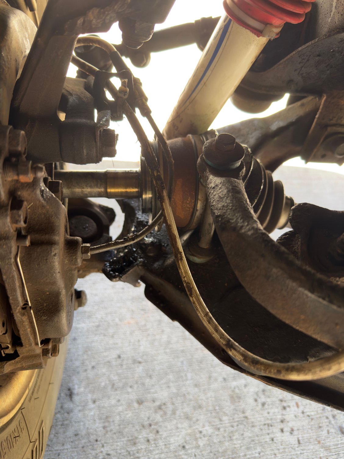

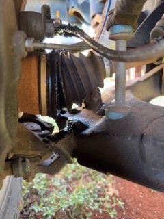

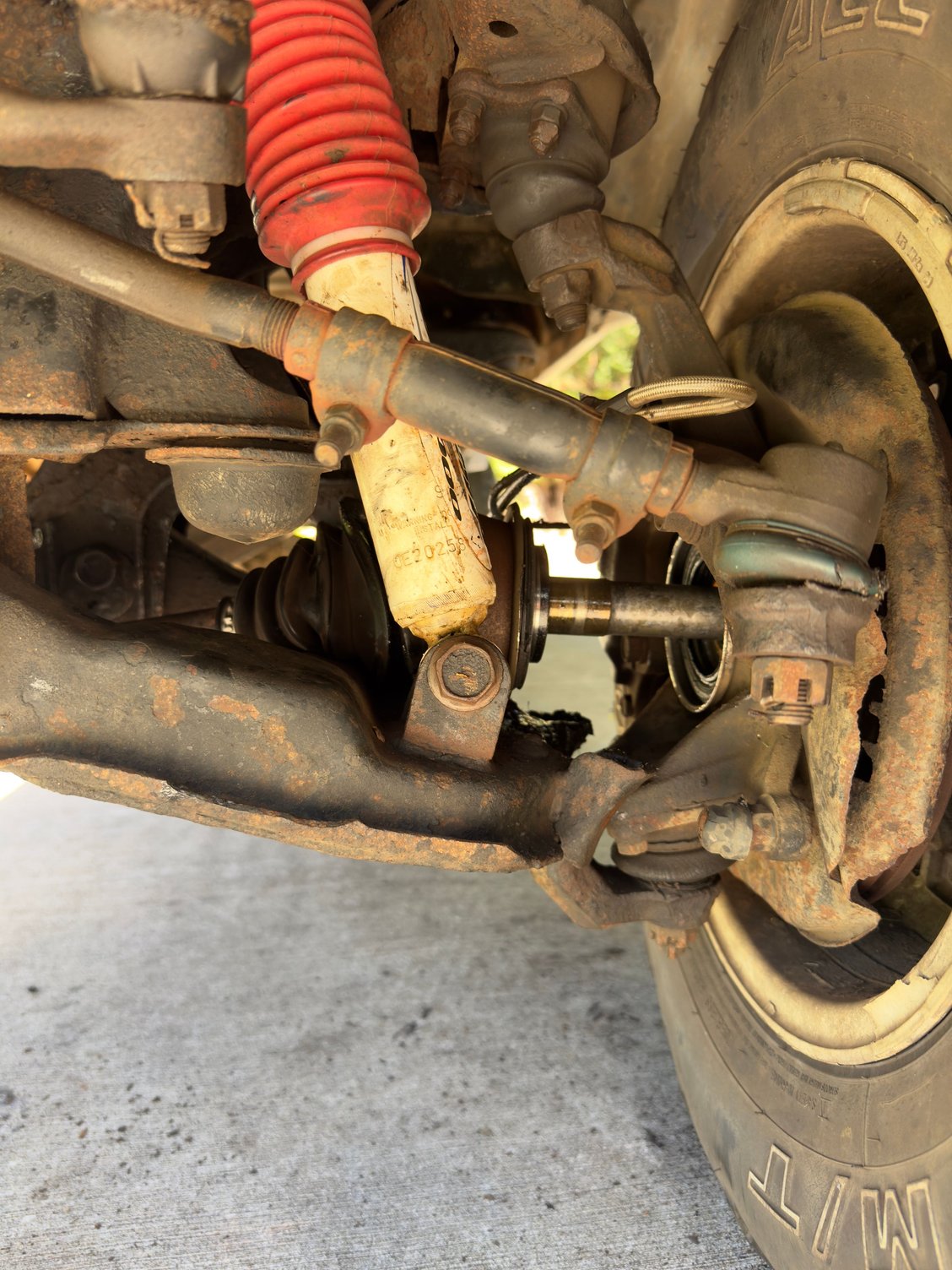

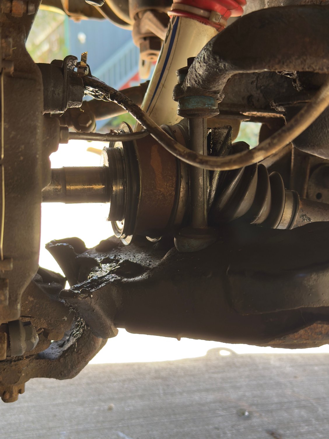

UPDATE: This is currently where im at with my driver side cv axle. This is a IFS system on a 1993 toyota pickup 4WD 22RE extra cab wtih a pro comp 4 inch lift
After spending about 9 hours yesterday just trying to get the 17mm nuts off the "tulips" as well as the cone washers off the manual locking wheel hub assembly... i finally got the outer half of the cv axle out which is currently dangling behind the lower control arm.
The problem im facing right now is that i need about 2 maybe 3 more inches more to get the spindle out of the back of the rotor. It is really tight against the lower control arm.
I had the steering wheel angled and from the top view it has enough clearance between the shock and stabilizer to pull through once i can get space under that boot.
I guess my question is, how do i get more clearance? I really dont want to remove the upper ball joint.... but i guess by doing so that frees up the rotor and such to be able to tilt outwards?
Whats crazy is that i've seen people on youtube pull it out easily lol. I guess they didnt show the actual difficult parts in the video lol.
Any suggestions welcomed. Thank you!

I usually remove the swaybar end links for that little bit of extra clearance. You have probably figured that out by now though!!!
Old Aug 23, 2024 | 01:33 PM
coopster's Avatar
Joined: Jan 2011
Posts: 695
Likes: 103
From: exo-reality -wave if you see me; Front Range, CO
FWIW, if you do remove the upper ball joint, just remove the 4 bolts on the top. I don't think its wise to bust the ball joint spindle off (the castleated nut part). Remember, your force is going to be on the top control arm (thats what the torsion bar twists). So be careful.
