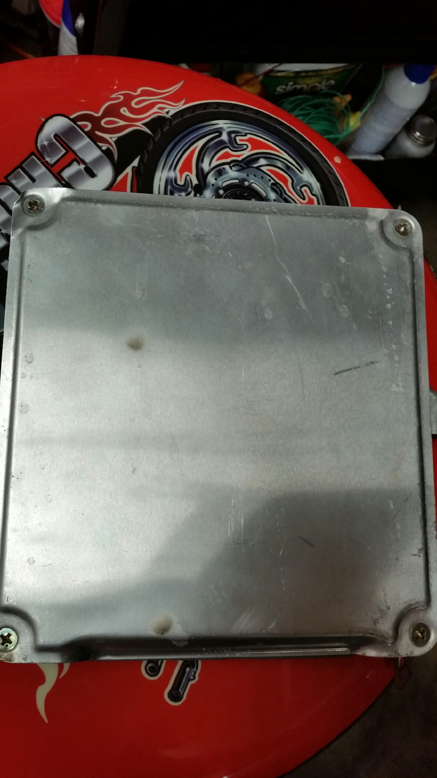

By chance did the ECU get wet??
Voltage spike ??
Other then physical damage to wiring corroded check connector .
Not much else will damage a ECU

Please see photos, looks like some drips of water but not a heavy flow. I opened the ECU and inside was bone dry with the exception a few dead cockroaches. I don't think there was a voltage spike but I charged the battery since I didn't drive it for 2 weeks since it was pouring outside. I rechecked the connectors and they all look good, like new. Continuity between the connector and the DLC was good at zero ohms. Thanks
