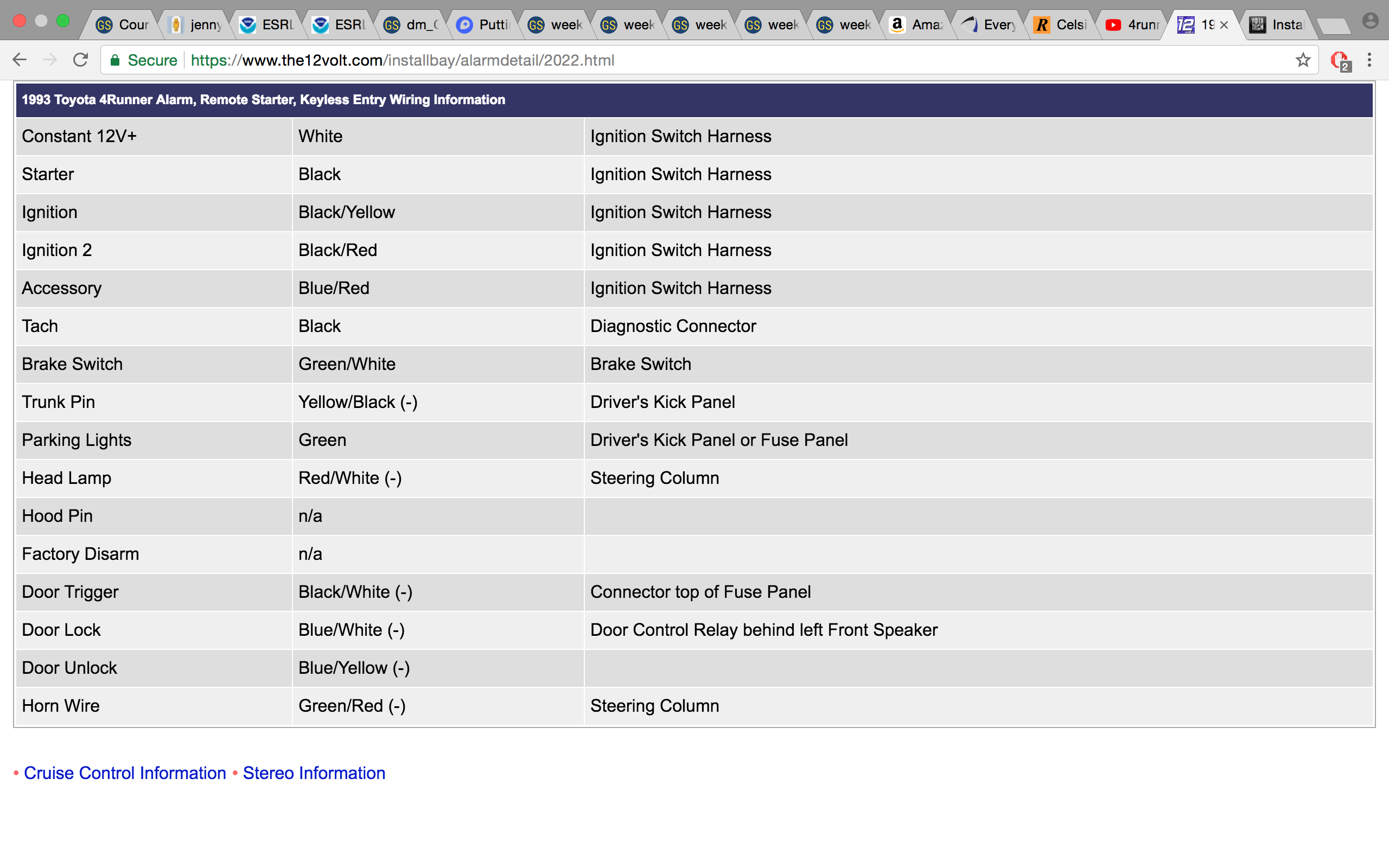

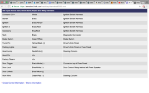

I have searched high and I have searched low, but low and behold I cannot find a writeup on how to install a keyless entry. I did find this chart that shows what each type of wires does but I'm not too confident in it.
This is the remote entry I am using
https://www.amazon.com/gp/product/B006QH9C5A/ref=oh_aui_detailpage_o03_s00?ie=UTF8&psc=1 https://www.amazon.com/gp/product/B006QH9C5A/ref=oh_aui_detailpage_o03_s00?ie=UTF8&psc=1
Does the chart seem legit, and how do I know which wires to connect to the system?
Do you know of a writeup on this?
Also I have heard it is a negative trigger, is this correct?
Thanks!!
