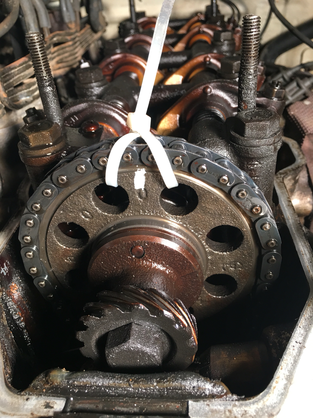

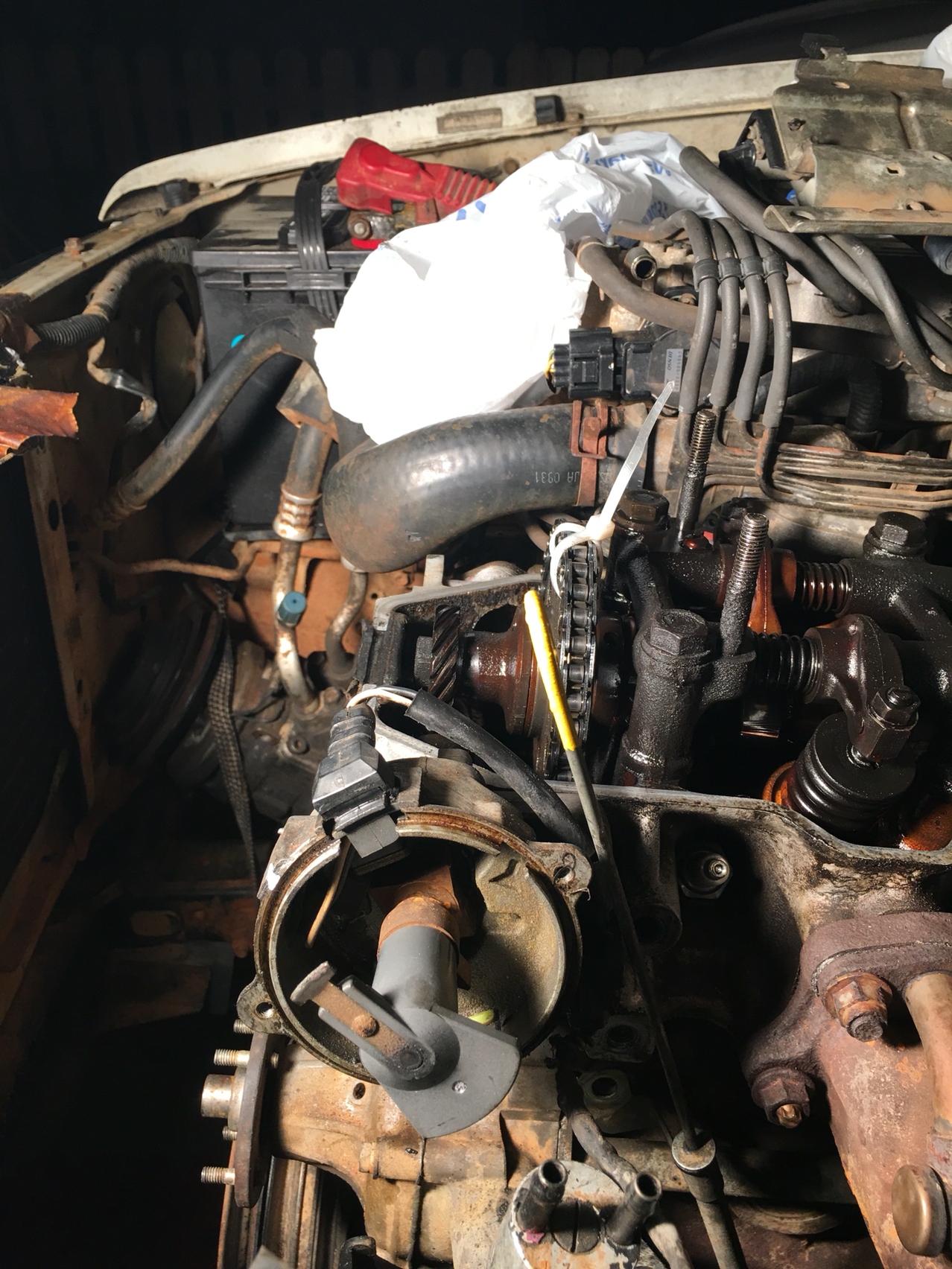

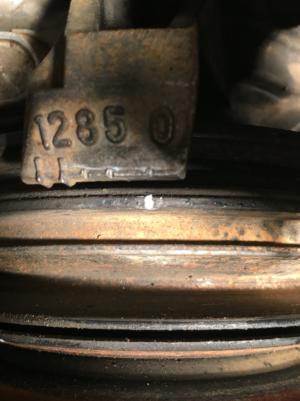

1993 22re. Am I at tdc?
The reason I ask is my sprocket doesn't have a dimple in it like my new one from Engnbldr.
Attached Thumbnails 1993 22re.  Am I at tdc?-photo970.jpg   1993 22re.  Am I at tdc?-photo438.jpg   1993 22re.  Am I at tdc?-photo702.jpg

Well with the crankshaft at 0* and the rotor pointing at the first cylinder you should be at tdc on cylinder #1. You can always take out the spark plug and point a flashlight in the hole to double check.
