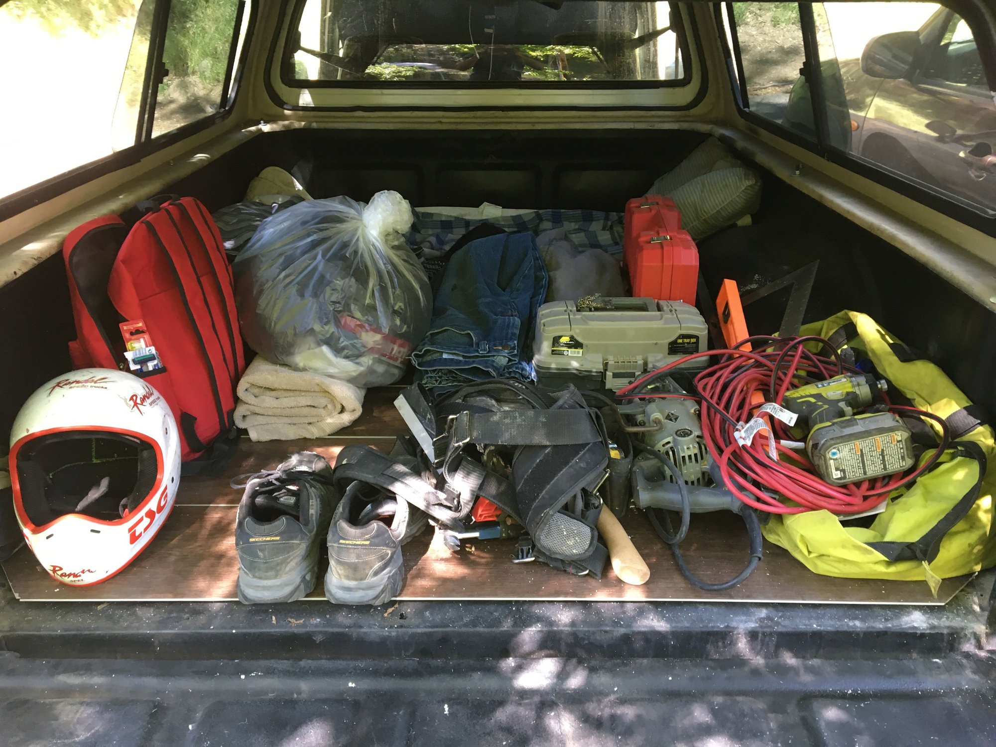

Thanks for the reply, yea that was pretty obvious haha. This is whats in it all the time.

1800 pounds would probably slow you down, and if you truly were carrying that every day then it probably wouldn't hurt to get some add-a-leafs. But it is technically rated up to that much. Carrying around what you show in that picture isn't anything to worry about. It's a truck after all. If you do need to really load that truck down on occasion, you have a lot of payload to spare.

You get a little crazy with that skill saw? Is that what the helmet is for?
