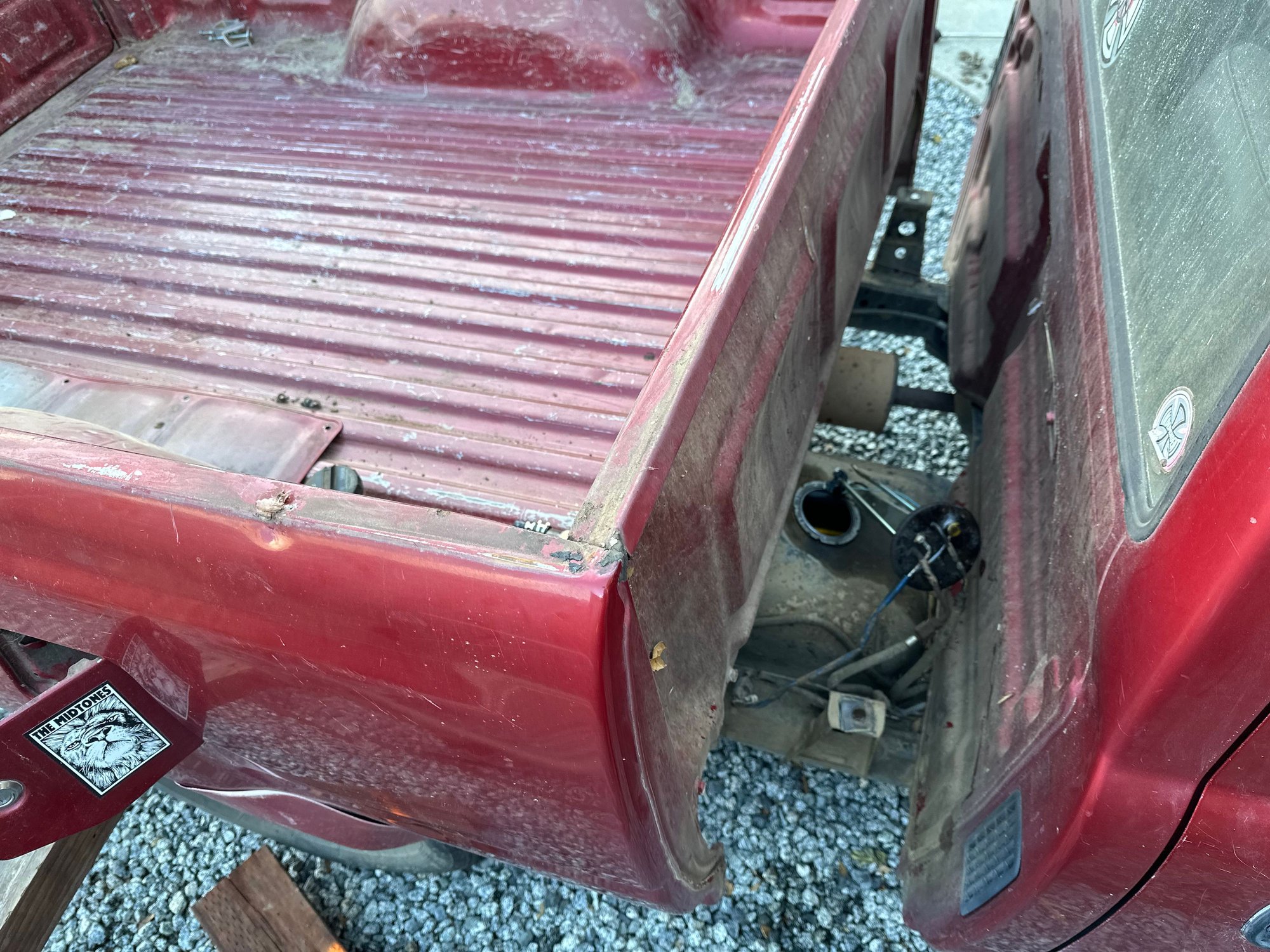

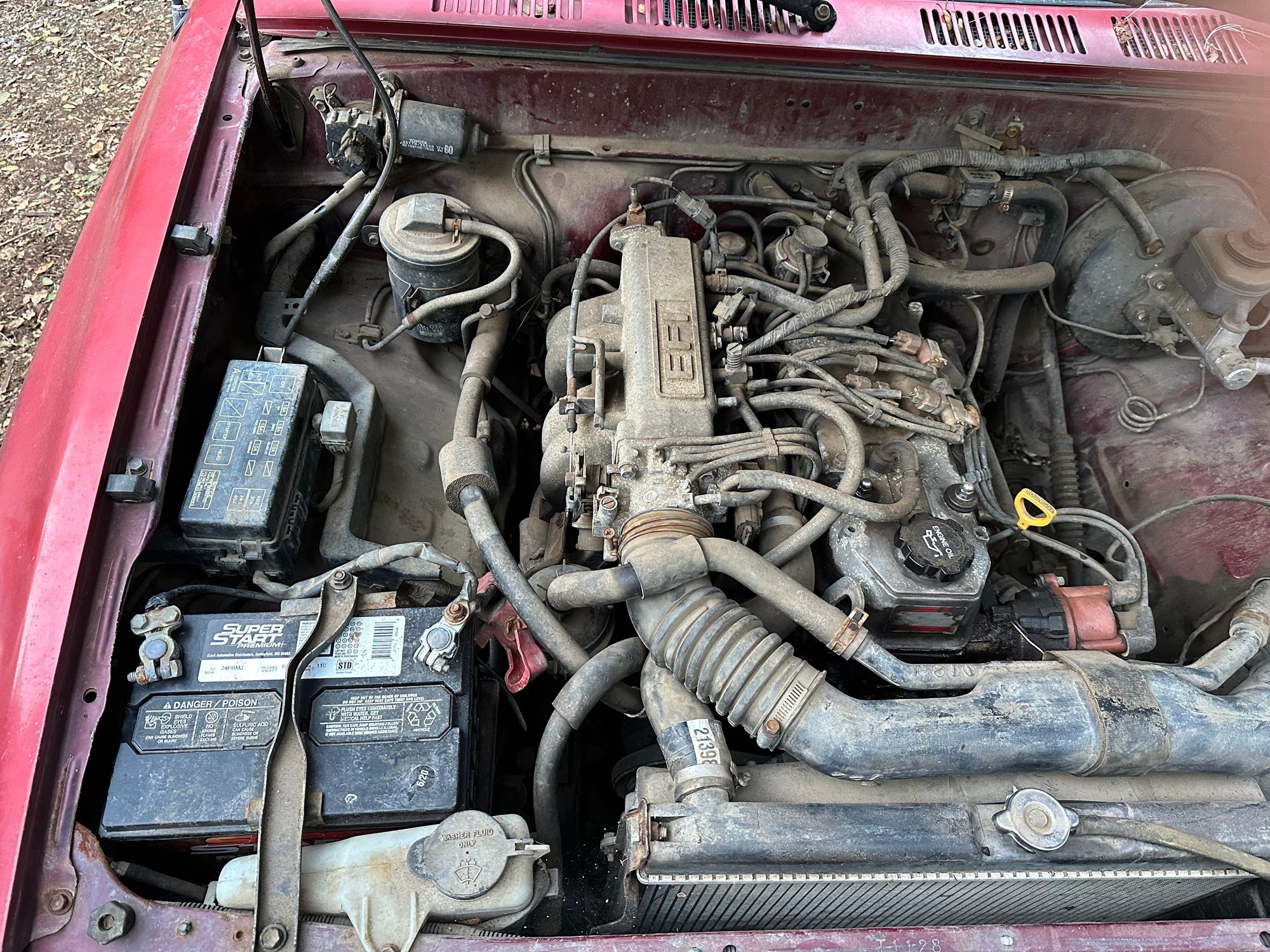

Hello all. I recently bought a 92 single cab 22re 5speed truck. I bought it not running. Would cough to life on starting fluid.
I got it home and it randomly started after hitting the fuel tank. So I replaced the fuel pump. Still wouldn’t start. HOWEVER it was really random, after sitting for a week it would start up right away. But after a minute or so of running it would sputter off and not start again. I replaced the fuel filter yesterday and it will still not start. What else should I check?

Just jumped FP to B+ and it started right up. Disconnect jumper and it dies.
