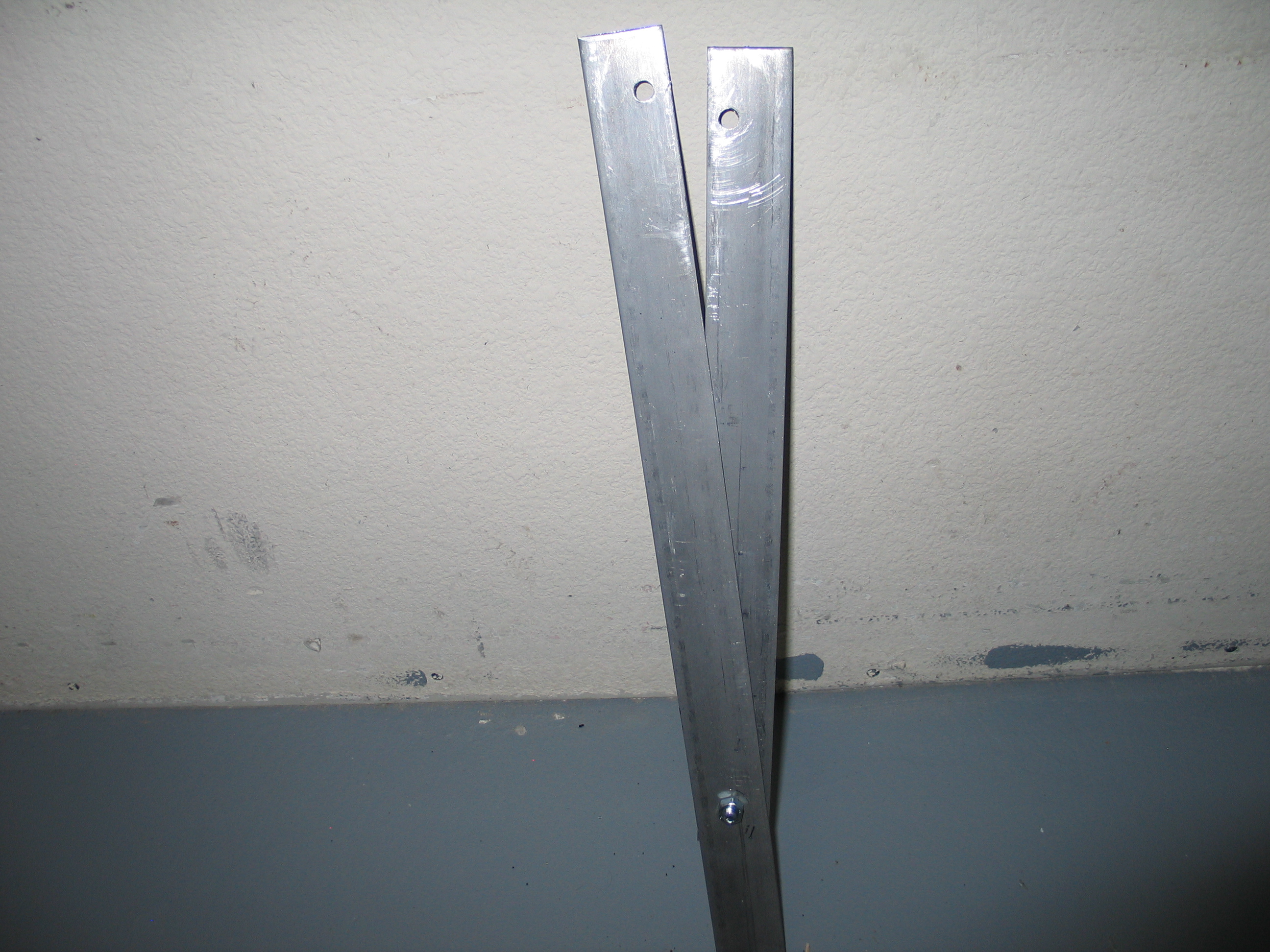

I MADE A CRANKSHAFT HOLDING TOOL got a 4 foot stick of 1/8 thick 3 inch wide, steel cut it almost in half, looks kinda like scissors for 15 bucks.
ill try and post photo of tool but i got the idea off google photos of crank holding tool. my ac idle barring is shot. its all apart ill update soon.

trucks all done, the new injectors are loud, had to turn it on and
off a few times to set the new fuel injectors.
crankshaft tool photo.
