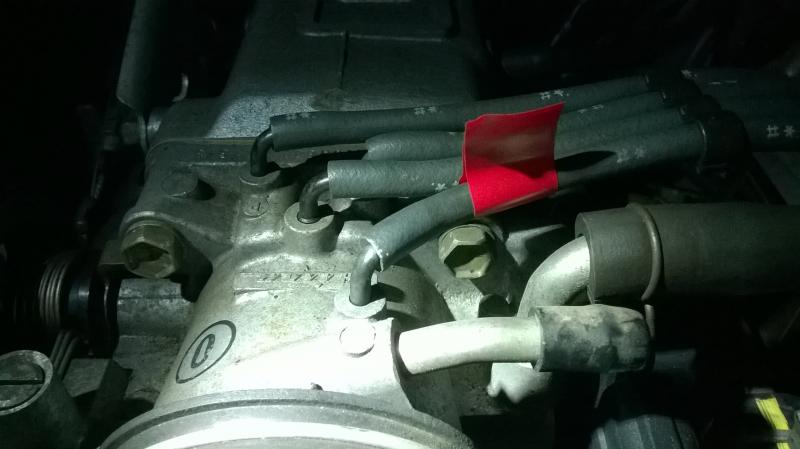

I just picked up a 1991 base pickup- 2WD, 5spd, 22RE with Cruise Control. Looking under the hood I can see someone has been screwing around under here. I found a hard vacuum line with no hose on it and a connector hanging down attached to nothing. I think someone has removed part of the emissions and they might have been connected to it from the factory. You can also see a steel plug that someone has fitted in the FI system.
I looked at the diagram that's on the hood but I can't tell what's what following that. I've never been able to follow those diagrams or the ones listed on line. Also as far as I can tell it's not a CA model with excessive emissions pieces. I do not have A/C either.
So what are they supposed to connect to and will it effect the way it runs?
(Yes I did plug the vacuum line for now)

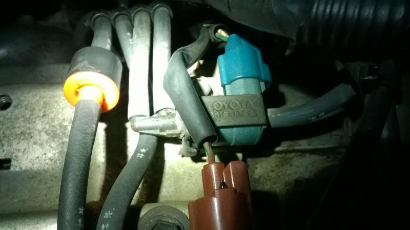

The Vacuum Hose comes out of a hard line that has about 4 other lines grouped around it exiting around the rear of the valve cover.

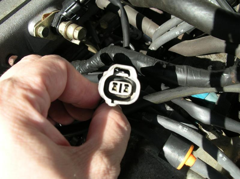

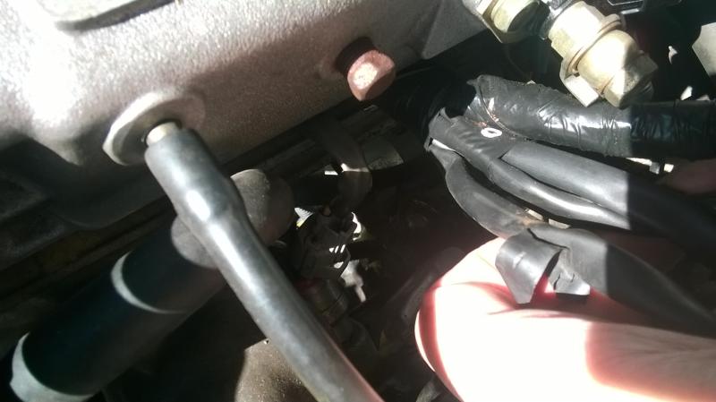

The mystery connector

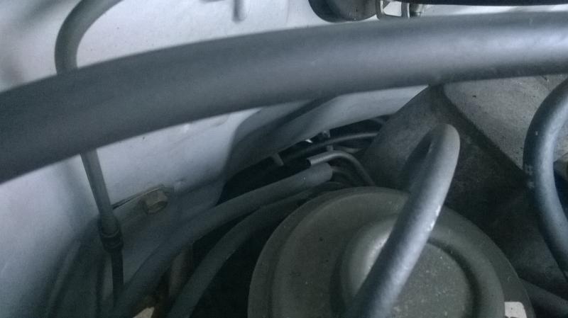

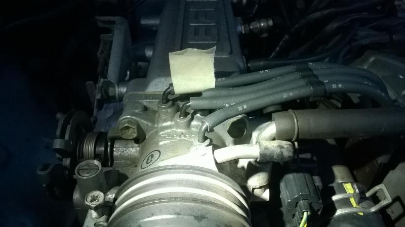

The connector wire comes out of a bundle of wires near the FI manifold. It is the lower cable with the loose black tape on it.
You can also see the rusty fitting someone has added to take place of.. most likely another vacuum fitting.

I can't remember where that first hose goes, exactly.
Pic 2: that's an extra plug. I'm pretty sure it has to do with A/C
Pic 3: Factory plug where the /C Idle Up valve would be located.

That vacuum line runs to the charcoal canister, the port near the firewall. 4907 is right about the other two plugs.

Ok so it sounds like the engine will not be effected as long as the vacuum line is plugged.
The truck doesn't have A/C so I should be good there.
That plug is pretty clean so it made me think it was connected to something in that area but I just don't see anything obvious.
So I just looked and I still have the charcoal canister hooked up.
Toyota part# 77740-35240
I followed the hose that comes off the Charcoal Canister and it's connected to the bottom pipe in this view.

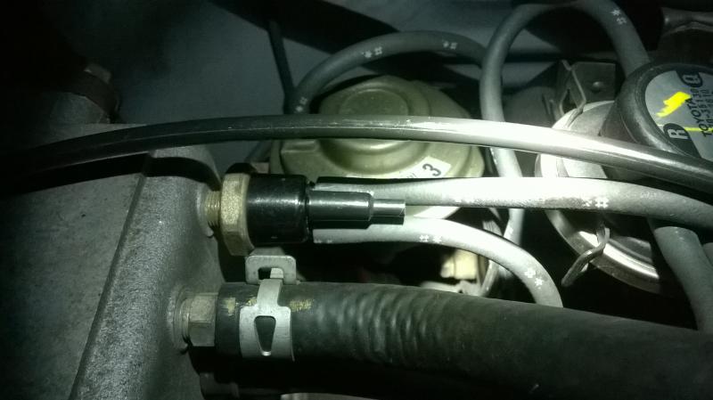

Then I followed that pipe and it's hose to the port on my throttle body that has the masking tape on it. That port in the throttle body is labeled P in the casting. I'm pretty sure that much is correct.

I followed the pipe that isn't connected to anything
back to a blue Vacuum Switch (Toyota# 90910-12085 pictured below) on top of the valve cover that has two hoses leading to it before exiting as one.
I followed the other vacuum hose and pipe that it merges with to the throttle body. It's the one with red tape on it.
Once the two lines are merged into one by means of the blue Vacuum Switch the single hose that emerges connects with a another valve at the very back of the intake plenum.

After following the pipe that wasn't connected to anything several times and comparing it to the diagram in shock I discovered it is supposed to connect to the Fuel Pressure Regulator.
Instead someone had left it uncapped as a slight vacuum leak.
So what the H was my Fuel Pressure Regulator hooked to then?
I didn't know what it even looked like so I hunted images of it on the net then I located it and followed the hose and pipe it was hooked to.
Turns out it was hooked to a different brown/red Vacuum Switch. (Toyota# 90910-12086)
I re-routed the Fuel Pressure Regulator hose to the correct pipe according to the diagram and placed my vacuum cap on the pipe that was supposed to be hooked to something called an AS Valve.
I then fired the cold engine up. Despite sitting all day it seemed to idle down quicker and the idle stayed consistent.
I had been having problems with that and thought maybe someone installed too cold of a thermostat or the coolant sending unit was really dirty, perhaps it was faulty.
Before this just a few days of intermittent driving made all of the plugs black and sooty. That's part of why I wanted to get the vacuum lines sorted out.
New plugs are coming tomorrow and we'll see how that does.
Back on topic- Now that means I still have a vacuum pipe that was at one time attached to the AS Valve.
Uh, what's that? I tried a search on here with no hits, I tried Google image search, I even tried a Toyota dealer part search and didn't get anything. What's the full or real name of it?

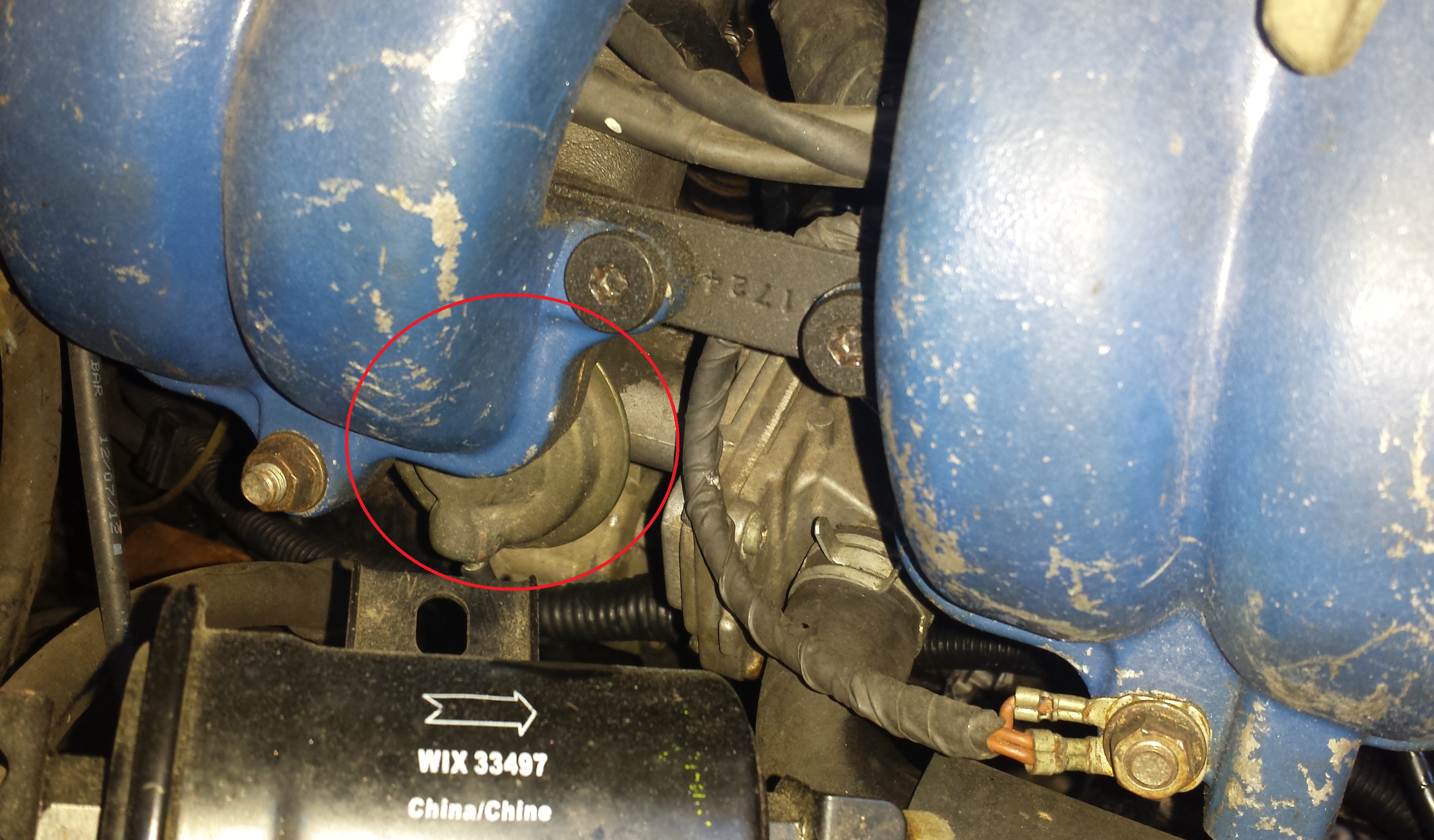

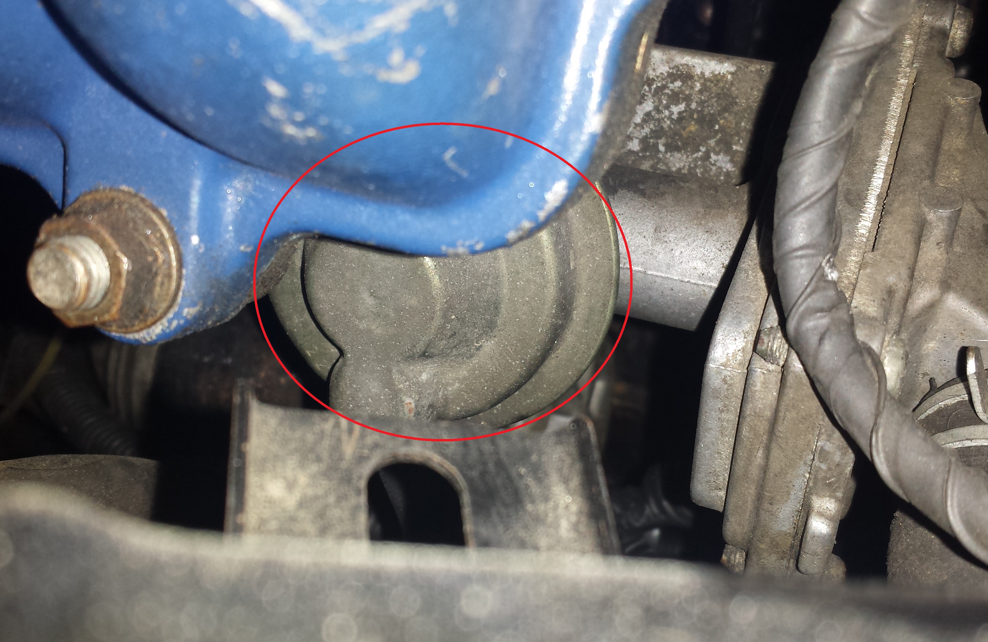

On most that is called a PAIR valve. It's under the intake near the rear (see the pics). The middle vacuum hose in the metal grid runs to it.
Attached Thumbnails 1991 22RE (FI)-Where is this vaccum hose & connector supposed to go? With pic's-pair2.jpg   1991 22RE (FI)-Where is this vaccum hose & connector supposed to go? With pic's-pair.jpg

It looks like someone removed the PAIR Valve (AS Valve) and capped the pipe that runs back from the exhaust manifold.
As far as I can tell everything else that the truck came with from the factory is still there and hooked up, correctly now.
The vacuum line that ran to the PAIR Valve (which I plugged) is the exception.
Is that going to cause me problems anywhere else if I leave it like that or am I going to have to take all the hoses associated with it off?
I don't care if all the other hoses are there they don't bother me as long as it doesn't create other problems because of the PAIR Valve being removed.

Some people do eliminate the PAIR; I don't recommend it but if it was done correctly you should be fine. Just pull the codes and see if there is something lurking you can't see....
As for the brown VSV, the top is just a cap. Just let that one be (probably the easiest fix you've had in a while right?)
