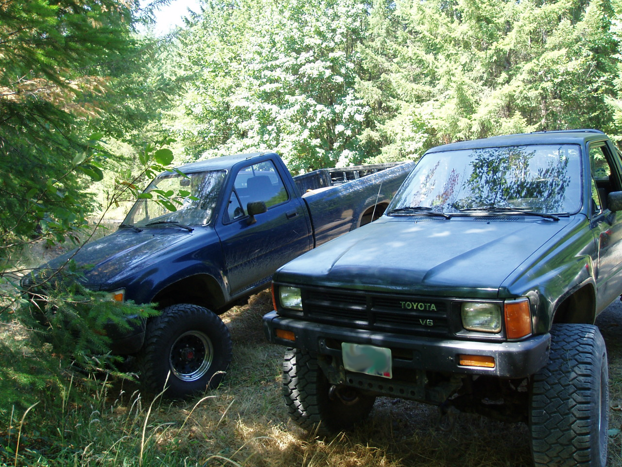

When I read through this thread awhile back(which I thought I'd posted in actually...huh?), I wanted to find the pics I have of the only 3rd generation 4WD long bed I've ever seen to show you. But I couldn't find them at the time. Then I finally remembered where they were here a few days ago. Now I've got them all lined up and ready to go.
BTW, they only made them from 89-92. So there are no 93-95 4WD long bed pickups(which's one of the reasons why they're so rare). And FYI, ALL 4WD long bed pickups are regular cab, regardless of the year they were made(79-92). So there are no 4WD Xtra cab long bed pickups. Basically, there are only 3 types of 79-95 4WD pickup bodies. Short bed, Long bed, and Xtra cab(if you think about it...it makes sense...because it's true).
Anywho, why not upgrade this thread with some pics of such a rare beast? Still sounds like a good idea to me. Better late than never I say!
89-92 3rd generation 4WD long bed next to my 88 2nd generation 4WD long bed.
