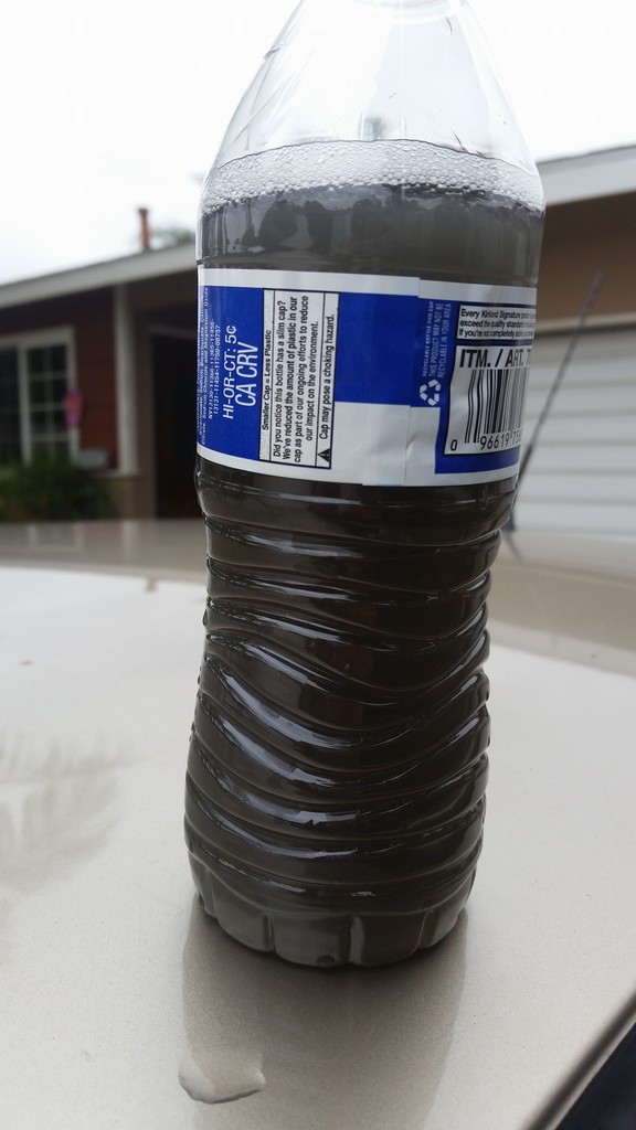

4) I strongly recommend a "heavy-duty" flush (refill with water and Prestone Flushing solution and drive vehicle for 3-6 hours over a few days) as described in Prestone's flushing solution container, not just the quick 10-minute one. You know how I know this? Even if the coolant from my 2007 Corolla came out a clean pink, and after I did 1, 2, and 3 , I did the "heavy-duty" flush and this came out of the system when I drained:

5) After the flush thoroughly drain system and rinse with fresh water thoroughly, then refill with coolant. Double check coolant level after each heating-cooling cycle after refill.
