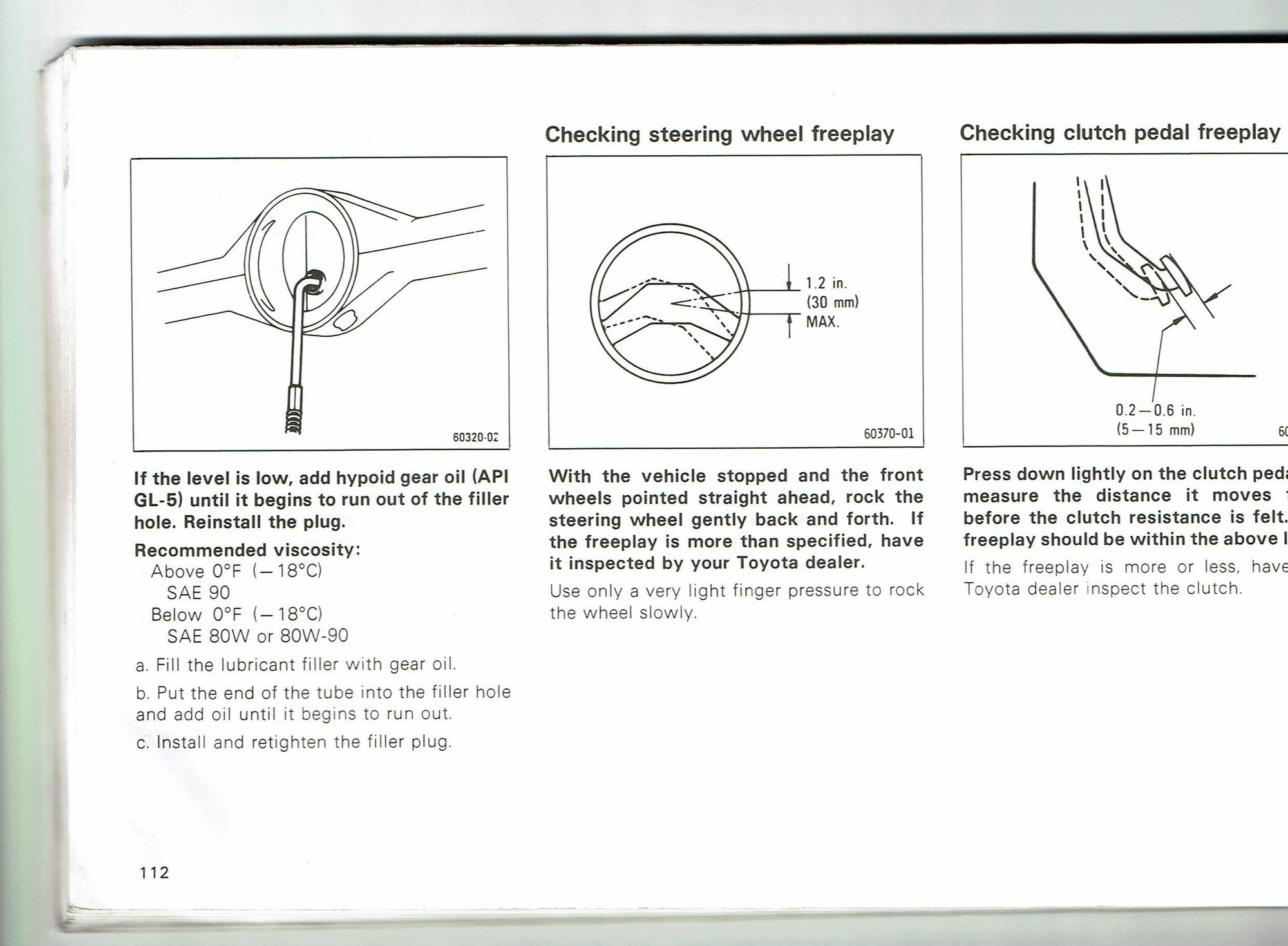

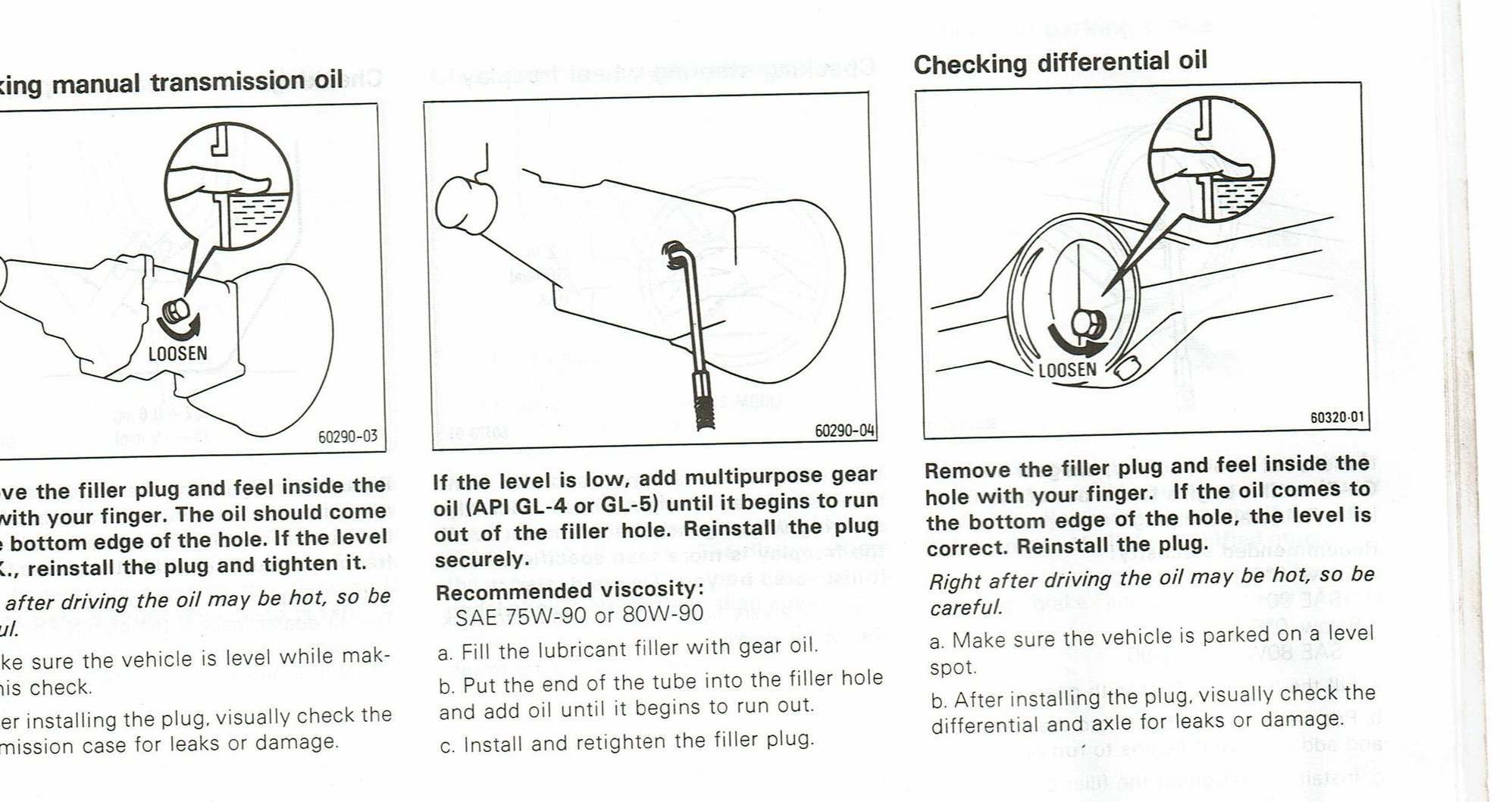

I highly recommend Walmart house brand GL-5 and Sta-Lube GL-4. But, as you can see. you don't need any GL-4 cuz GL-5 is OK in your manual toyota transmission since at least 1985. Now my Troy-bilt roto-tiller specifies GL-4 and that's what I use. But, the rototiller is ancient. There may have been a time when the gear oils DID (past tense) contain a chemical component that would attack copper and copper alloys. But them days be gone forever. Urban legends, old wive's tales, misifnformation, etc. persist, as well as ignorance.

Going to have to disagree with the gl-5 supertech, yes the spec says gl4-5 but I've never experienced shifting problems untill we put in 2.5 quarts of the super tech gl-5 stuff. There are plenty of other occurances of the gl-5 not working well with the w series syncronizers which I we I'll add to. No bueno! Gl-4 MT spec lubricant...

I guess my transmission is a either a liar, ignorant, or believes in fairytales.
My post is based on me using both GL4 and GL5 fluids in my transmission. First change I did was with GL5 and it made the 1-2 shift very crunchy and it would grind a bit every time. Didnt do that before the fluid change. Came on here and read many posts about how GL5 can make the trans feel like that. So after less than 5000 miles, I drained the GL5 and put in the MT-90 GL4 and it smoothed out the crunchiness and grinds on the first drive.
Just because something is put in a book, doesnt mean its correct
