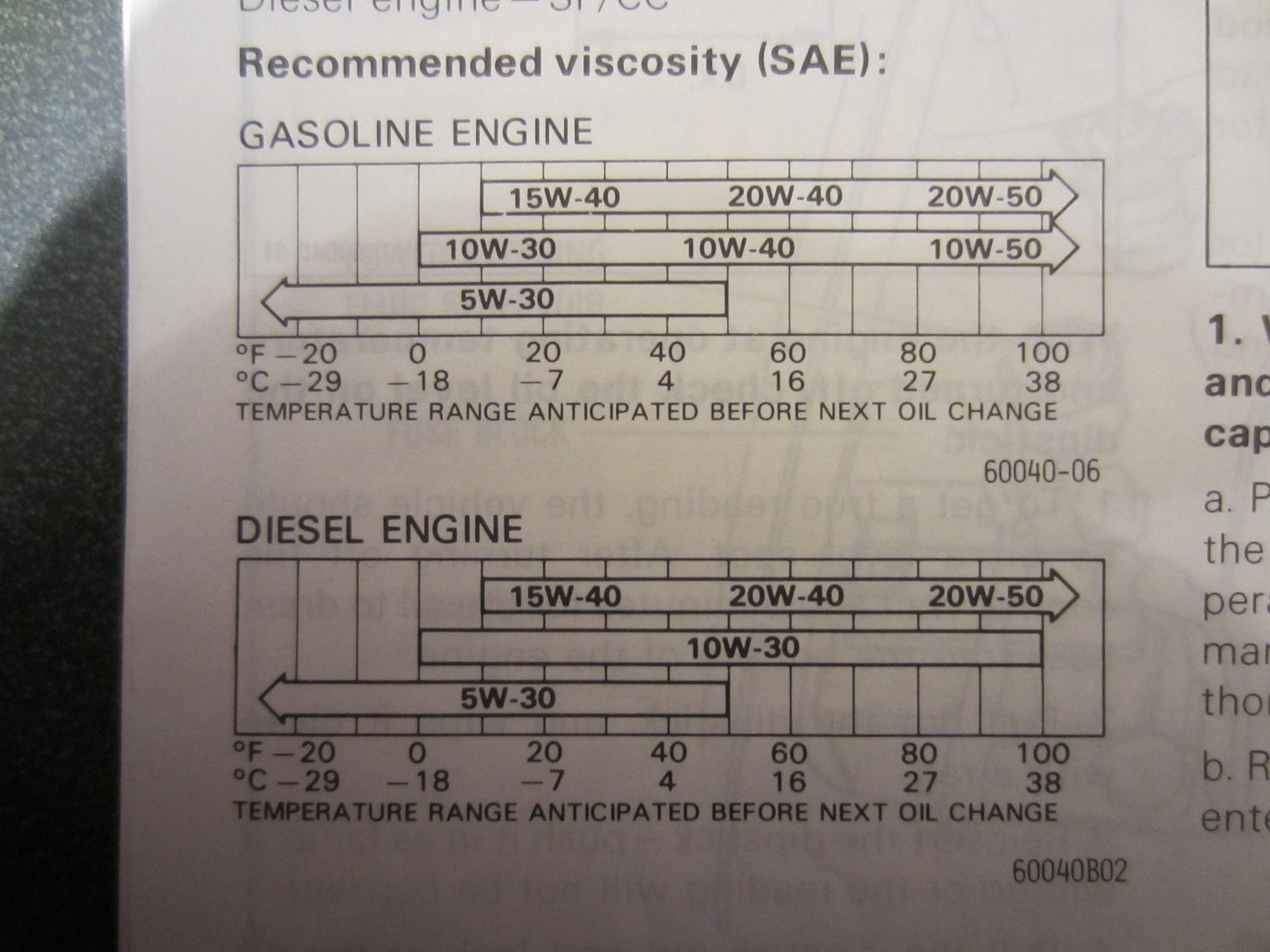

What part of California do you live in?
California is a large state. The temperatures can get quite cold in the Northern part of the state, while the Southern part stays warm year around.
I personally run conventional 10W-30 oil in my truck, with an OEM Toyota oil filter.
Once you start searching, you will find many different opinions on the subject.
Here is what my Owner's Manual says:
The back cover of the manual says, "Use SAE 10W-30 if normal temperatures are above 0° F (-18°C). For other viscosity recommendations, see page 108 [shown above]"

I live in the bay area
Santa Rosa ca to be exact
