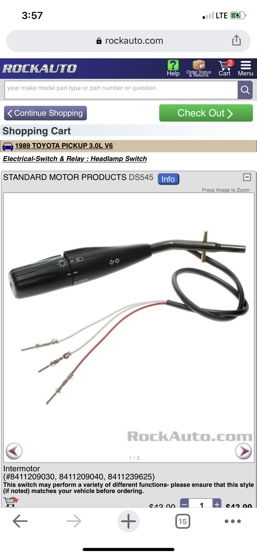

Paul, I think it may the brake switch above the brake pedal....the reason of why my brake lights are staying on. I am gonna order a new one and see if that takes care of the brake light issue, and if it doesn’t then I will order a new turn signal switch and if that doesn’t work then I will have to run down the wiring gremlin. Only thing I can do. I have exhausted all my other avenues so far..why not spend kore money in a truck? 😂

I will check that. I was already looking up switches too. Not too bad on the price. I did check where the button was at. It is OEM. It has completely broke off so that could be the problem. I will have to check it tomorrow. It is already too late to do it. But best believe I will though. I will keep ya updated too. Thanx for the help man. I am glad I joined this forum.
