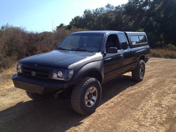

Can't put the turn signals in the custom bumper, no place for them! See photo below to know what I mean. The bulbs are not LED. I was thinking about changing them over so that they would be brighter than what's in there and then maybe, just maybe other cars could see my turn signals!

Here is how mine sit I like them and you can see them.
You could do the same think quite easy
