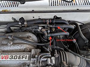

Hi Guys, been lurking for the past year since I bought my 1989 3.0 4runner but I've come across a question I haven't found a solid answer for. Please direct me if this has already been covered.
I'm looking to replace all my radiator and heater hoses and the only kits I'm seeing are the HPS ones available on amazon for about $200 ( ). The thing is, these are listed as being for the 89-92 V6 4Runner, and from what I can tell, my 89 (2 door, first gen) is different from the 2nd gens. None of these kits include hoses for the rear heater, but I'm planning on removing the rear heater core and doing a bypass at the firewall when I replace hoses anyway.
My question is how different are the hoses on the 1st gens from the 2nd gens? Could one of these kits work for me? I already checked to see what WabFab offered but it's just the big hoses for the radiator. Does anyone have experience using different hose replacements? Can you just buy some heater hose and bend it to the shape you want?
I'd also appreciate if someone can verify for me the two components that would need to be connected for my rear heater core bypass (all the mods I've seen look like they're on 2nd gens)

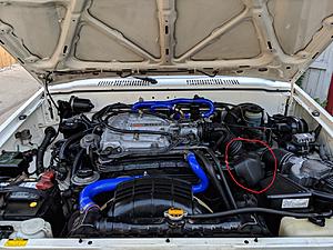

If anyone else comes across this, I have since installed the HPS kit with no problems regarding fit. The HPS kit was only available for models without the rear heater core but since I removed my rear heater core anyway, the kit worked for me. The kit would still work if you wanted to include the rear heater, you'd just have to make a couple cuts of the hoses and need a couple more hose clamps. Attached are some pictures of my install.
As you can see, the two metal pieces forming 3-way connections are the supply and return from the rear heater.
The new hose kit completely eliminates one of those connections (rear hose is now one continuous part) and for the other, I simply cut the third connection off and ground it smooth, slipped some old hose over the pin hole opening and clamped it.
