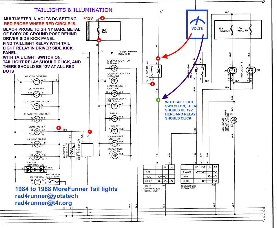

PLEASE IGNORE MY NOTES. JUST LOOK AT SCHEMATICS.
Tail Light Circuit:
Head light:

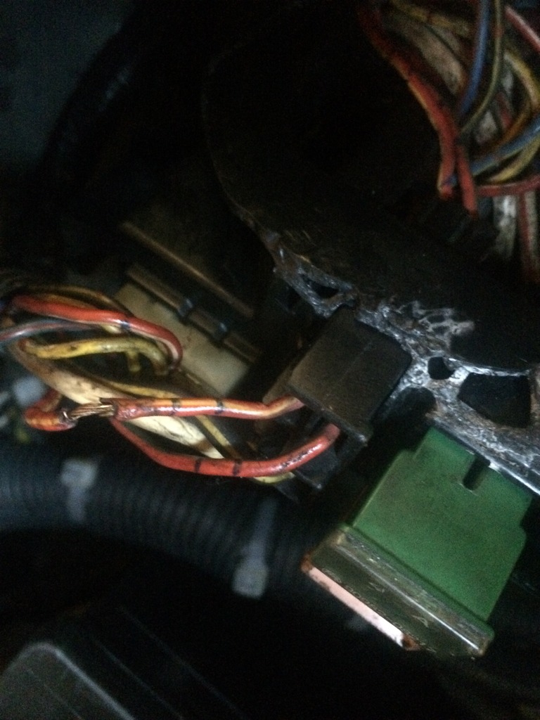

thanks Rad! Yesterday, I poked around a bit with a multimeter and found the bypassed wire was bypassed for a reason. I got power off the wire next to the fusebox, but not in the cab.
(found out the fuse box was broken when I pulled it out lol tried to glue it back together)

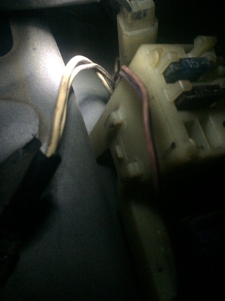

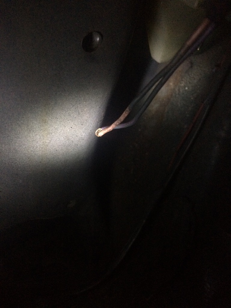

while I was in the cab I found a couple of dangling wires on the driverside.
they seem to splice in with the two white ground wires

I've never seen wire color other than white with black stripe go to ground.
The cleanest approach if you want your truck to be reliable is to restore it to stock wiring. However, you need to tell us what engine you have. 22RE schematic is different from 3.slo.
Also need clearer pictures so we see what you are seeing. (I take the time to make things clear on my illustration. I expect people needing help to help us see things right before their eyes that way, too.)
Please take a clearer picture of the fuse block, and where that module/block is with respect to other parts of the fuse block so we see what you have in front of you.

From memory, the purple and pink wires normally are for the driver's side speaker and has an odd connector for the speaker that is almost always cut off. Multi meter your radio plug to those two wires to validate that's where they go.
What fuse block is broken? I should have a spare from 86-87 pickups, and I have a 86 4runner. Could go for the whole harness (if I have any not hacked up), or go the splice in route if it doesn't disconnect a simple way.

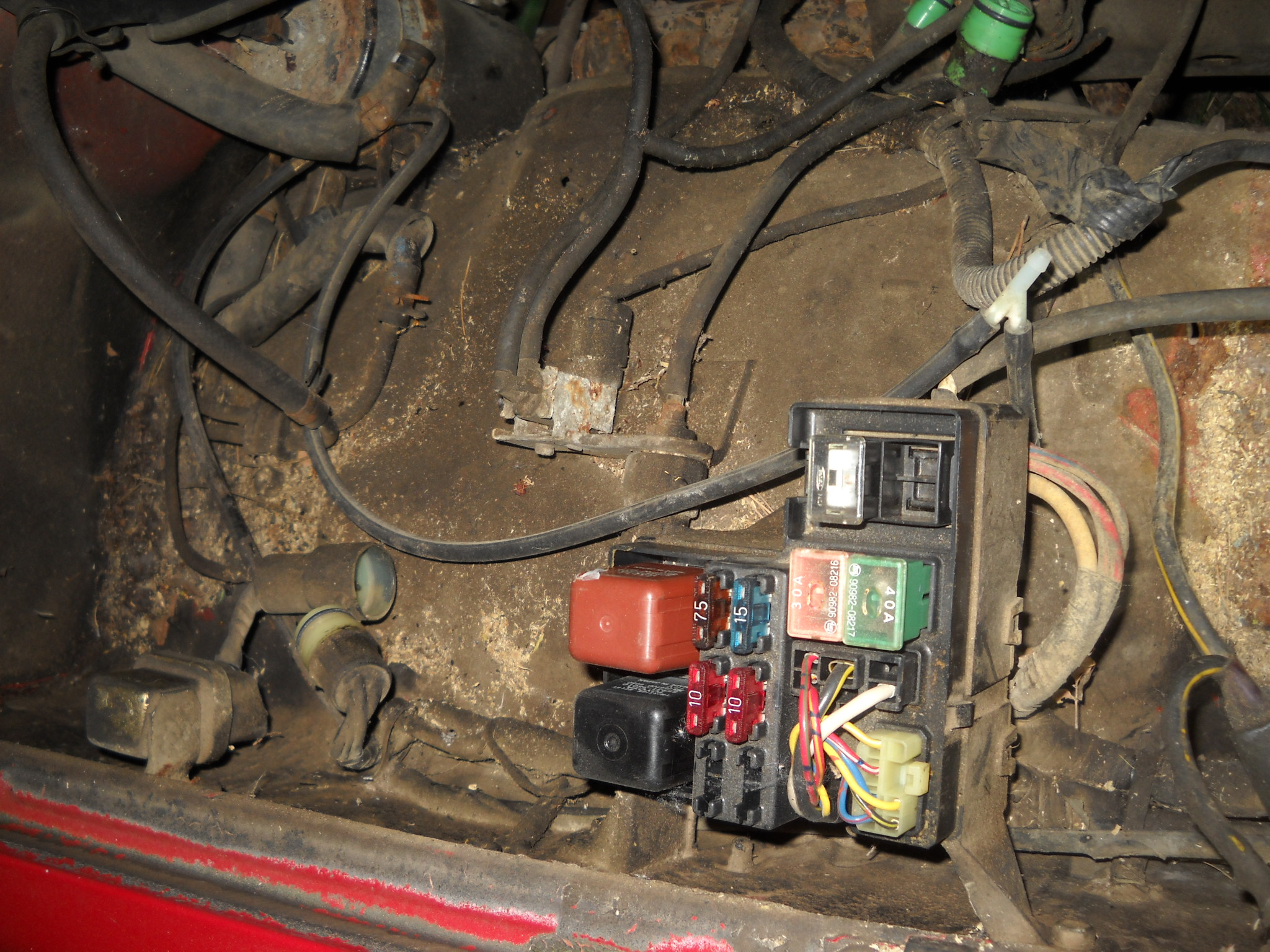

I guess why not lead by example, just took photos in the dark, but my camera (not a cell phone, but it is pretty old) takes fairly good pics at night. I didn't think to snap a couple of the head light harness. Pretty sure the pics of the half destroyed fuse box was the passenger one, so here's some photos of it. Based on the EFI truck I pulled about lately, that fuse box is part of the ECU harness, so I suspect this one is the same for the mini-ECU or as labeled "Emission Control" which is part number 89550-35240. Speaking of part numbers, there's probably a part number on the harness to reference. Anyway, it's dirty under the hood, but the harness appears to be in good shape. The truck ran, but the manual fuel pump seems to have died, it ran fine if I dumped gas in the carb via vent tube.
It's hard to see in your photos, but it looks like the black with yellow stripe wire isn't in the same spot on my harness vs yours. I think that is a ground wire, maybe half your problems are from the harness not getting a proper ground?
