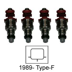

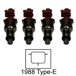

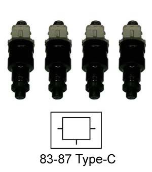

88 is a one year only injector. They have red tops like the 89-95 but have a different resistance value in them. Flame Thrower will know the 88s are different. Just make sure his truck is an 88 model.

He needs to order the 88. Besides the resistance difference, the fool proof tabs keep them from being interchanged. The 85-94 22re had three different injetors.
each diagram shows orientation of the plug connections.

Thank you Terry! I was able to get a hold of Curtis on eBay today and he said to order the 84-87 and then call him to let him know it's for an 88 so that he can supply the correct wiring adapters with the injectors.
