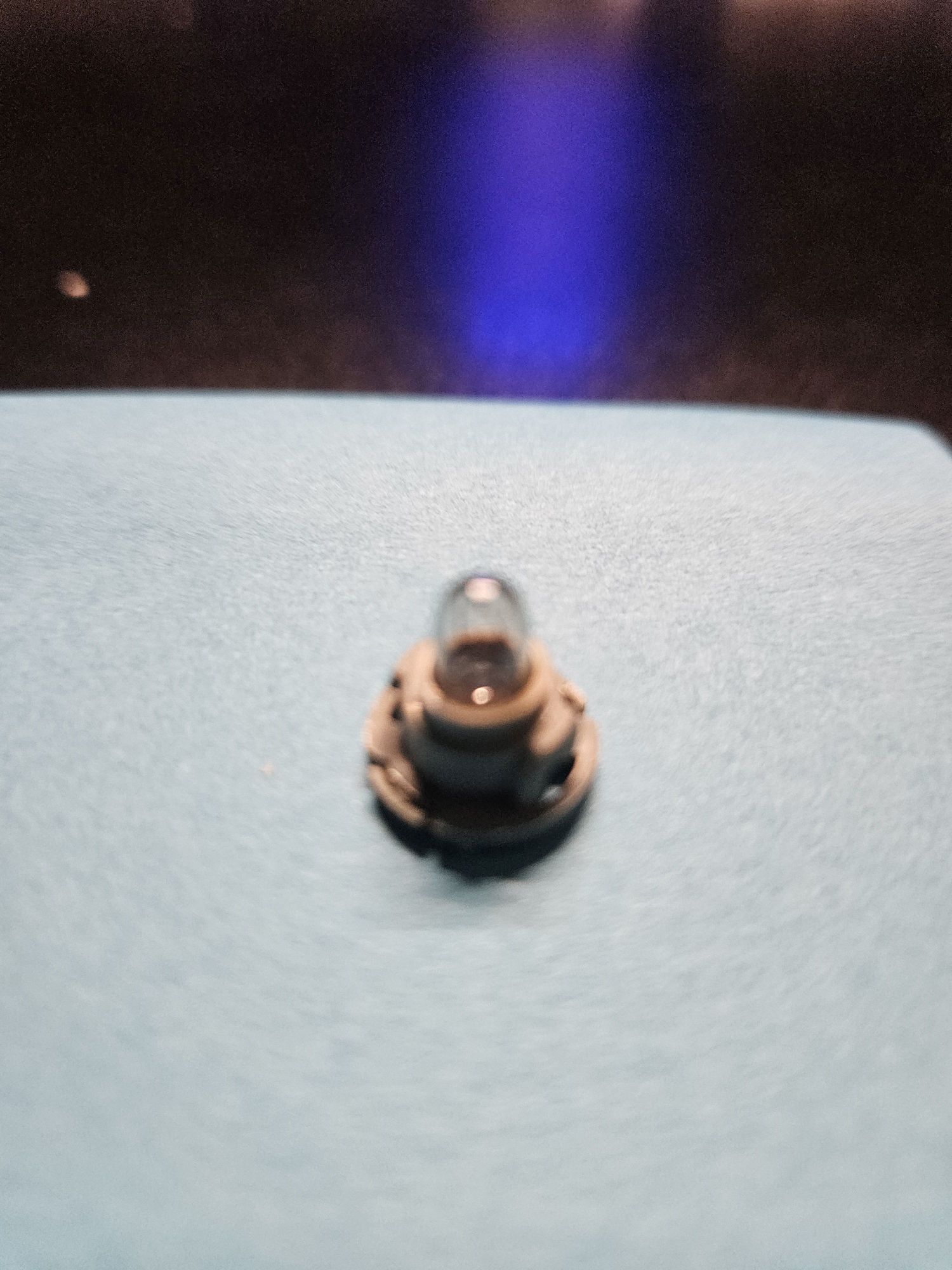

I'm looking for the bulb that is in the air conditioner on/off switch on my '87 pickup. Has anyone had any luck finding one?

It’s been a looooong time since I swapped mine out for an LED but I swapped mine in 2013 but I did pull up my order history and I think these are the ones:
https://www.superbrightleds.com/neox...packamt-single
I got blue cause it’s AC but they have 3 size options and I show I got the neo3 3mm one. BUT if these interest you they have very good dimensions to compare to the original one in your pic. I also may add this was on my 91 so I don’t know if the size is the same. If you want to keep it original halogen I’m not sure on the correct part number I’m sure someone may chime in with that.

Awesome!! Thank you so much!!! I looked on their website but I guess I didn't use the correct lingo. I really appreciate your help!!

No problem, and yes most of the bulbs come up with the vehicle finder but little bulbs like that one and some of the dash bulbs you have to hunt around the site for.

Turns out the NEO5-GHP fit perfectly in case anyone else has an '87 with the little square AC button.

Excellent!!! Weird they are bigger but I guess it is a different year and I think the switch also had some changes. I also wanted to change the indicator light when pressed but after looking it would be a task as it’s soldered to the innards of the assembly itself and isn’t replaceable. But glad you got it sorted
