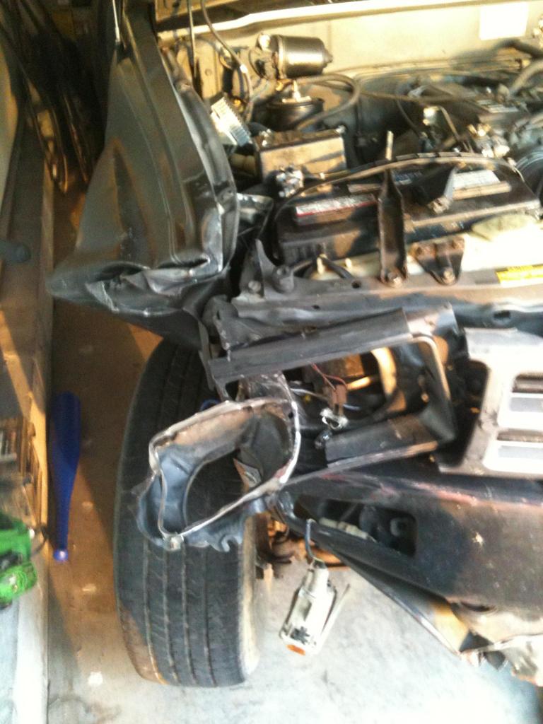

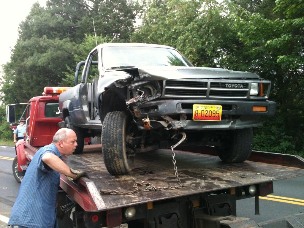

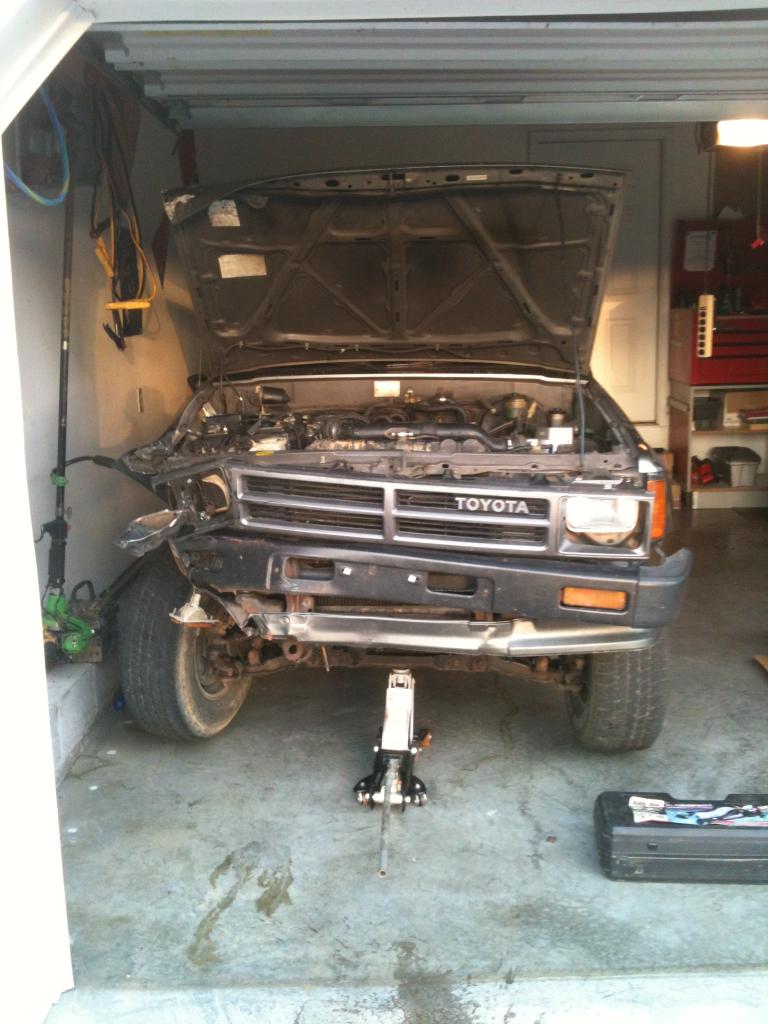

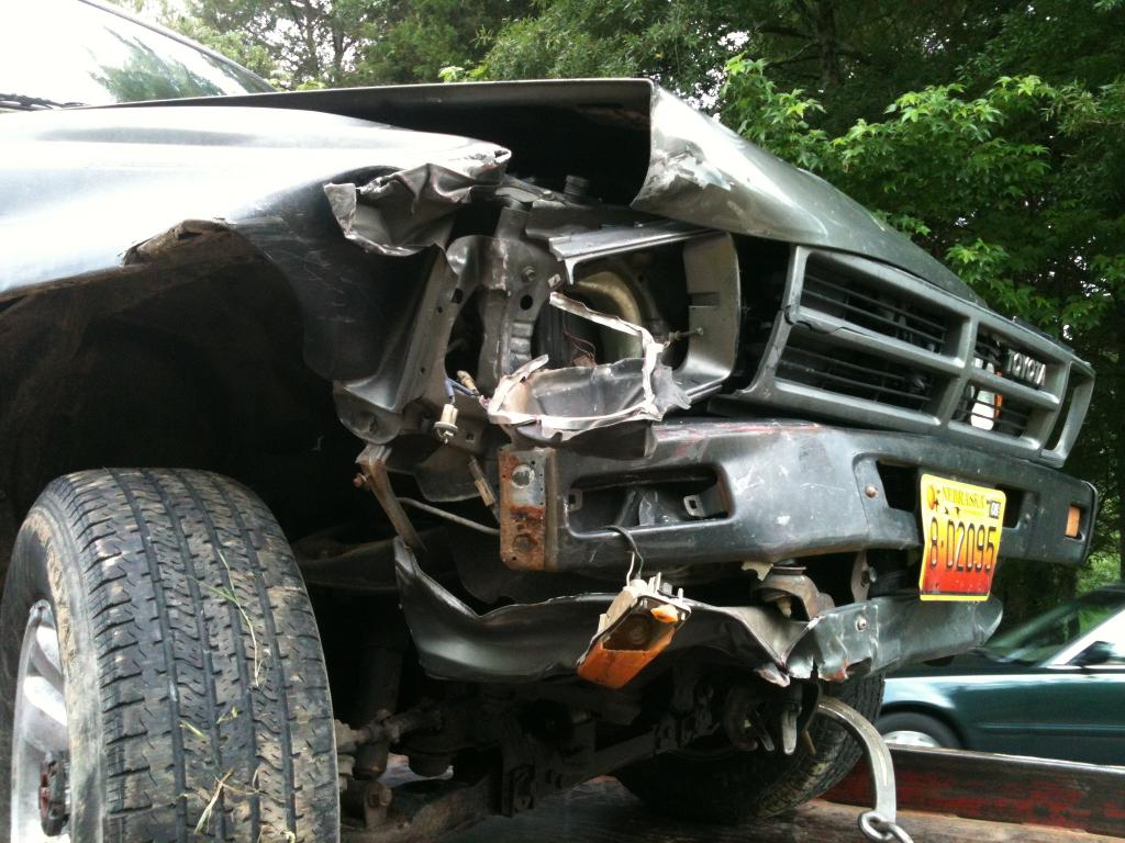

Well its almost been a year since my last post and that's cause I totaled my 4runner! . It happen back in May 2012. I was heading south bound and a lady in a Ford Turd was heading north bound and she decided to she was going to turn in her driveway right in front of me. So I hit here doing about 45mph and supn her around up into her driveway. Long story short her insurance company ended up giving me $2600 and I only gave like a $1000 for it.Name:  IMG_0849.jpg
