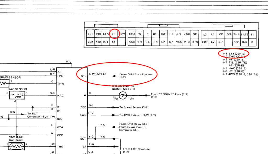

I have a print 1986 FSM and found that on 1988 22R-E ECU also takes part in grounding STJ. (Note the additional wiring between STJ of CSI timer and STJ of ECU below. Quite possibly same as in later engines)
I do not now about the 1987. TrafficTechII and others who have 1987's , when you get a chance, pls check is you have a wire connected to STJ pin of your ECU and let us know what color.

Rad4runner,
Mine is the 22R carb.
Did they use the same terminal block from the 22R/Carb to the 22R-E?
I will check and see what I have..
