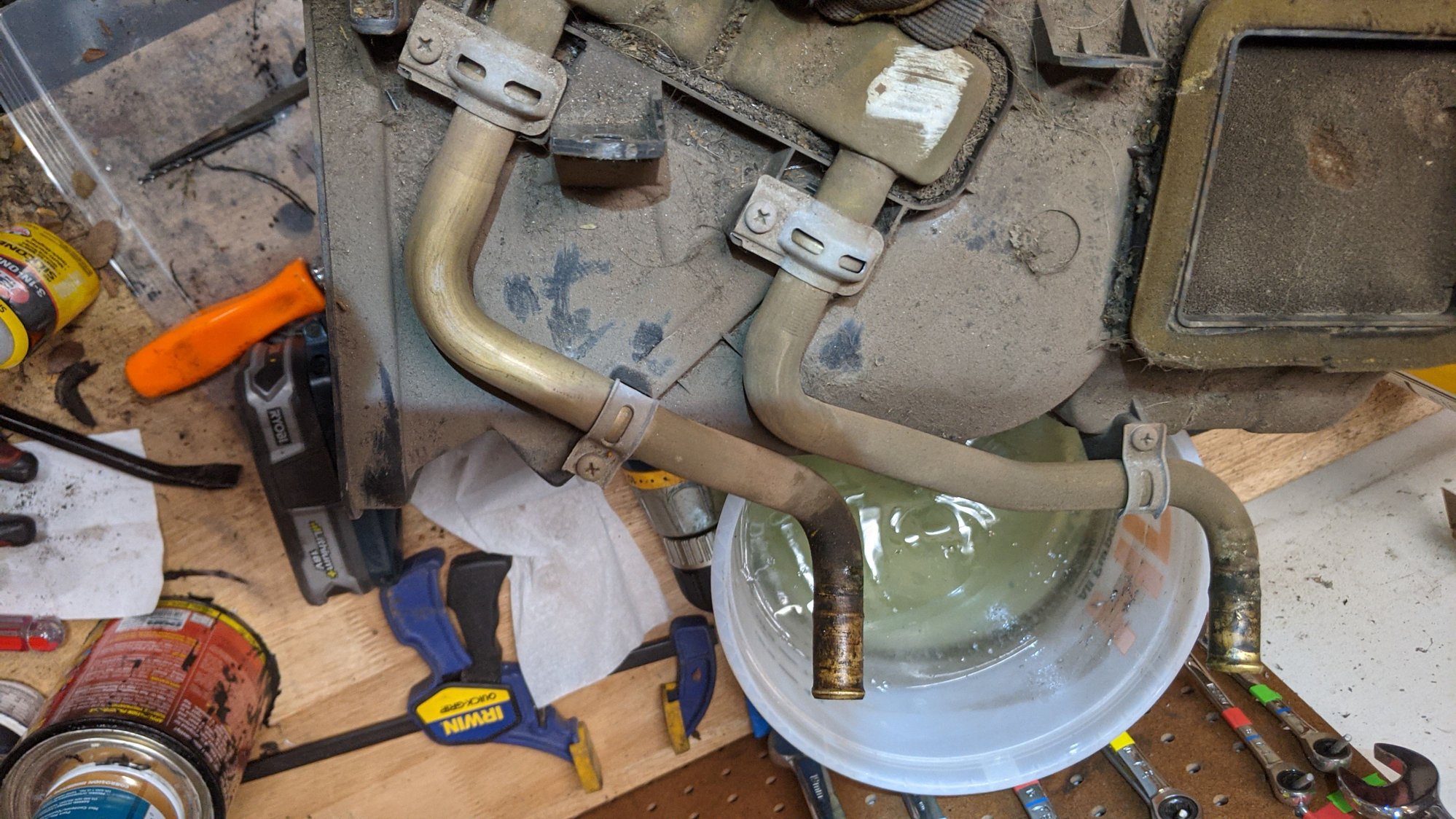

Does the heater core for 1987 4runner, 22RE, DLX, AT, AC disabled, : does this core feature two very long coolant pipe tubes protruding? Saw a few options on Ebay but one buyer complained it didn't fit.
Any ideas what unit I need without having to suffer having to dismantle under the dash? JT4RN62S5H0177665

it looks like maybe I didn't take a picture of the full unit, but this is a top down shot of the heater core in my 87 runner, manual no rear heat.
Hopefully that helps a little bit. If needed I could probably go take some measurements

this looks like the APDI 9010006 replacement I found online. Didn't expect such weird length and bend of the protruding pipes.

I gave up finding correct heater core replacement. Dimension were wrong or extant ion tubes didn’t fit. Took original to radiator shop and had it repaired. Was cheaper than replacement and no fitment issues, also had extension tubes brazed to heater core eliminating c-clips and o-rings.
