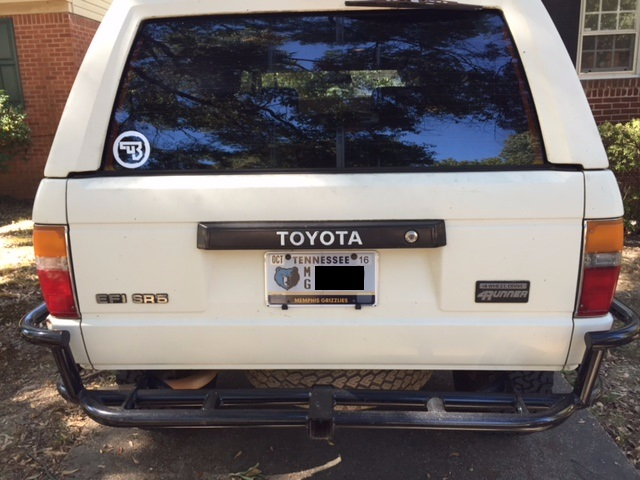

Hello yall, Im kinda new here, but know how to use search and google.... Cant find anything on this or how to fix it. It seems as though something inside of my tailgate is scratching the crap out of my rear window. Its all in one perfect line in the center of my glass if looking directly at it and some at the left side. It seems like as the window is lowered the angle of the window is causing it to scratch on something inside of the tailgate?
Does anyone have this same issue or have any suggestions on how to fix it? I plan on buying the window repair kit from eastwood to fix the scratches, I just want to be sure the glass doesnt get scratched after repairing all of the existing scratches. Heres a photo of what it looks like:

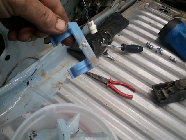

There is a clip that holds the plug against the tailgate and is most likely broken. I fixed them with zipties in the past.

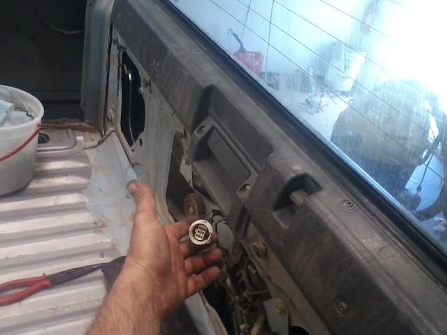

This plug was laying loose and is what causes the streak in the back glass. Mistys runner has it bad. Toms was laying loose and you can see some faint scratches in the back glass.

Found the holder that holds the License plate light plug. It is broken and was laying in the bottom of the tail gate.

Man, That blue plastic piece looks to be very similar in width to my scratch going up and down the center of my rear window.... Did you replace the blue clip with anything after you took it out? How is your license plate light sitting without it?

It has been a while since I fixed one and don't exactly remember how I did it but I was able to zip tie it back in place.
The black piece on your tailgate that says Toyota on it is what holds the license plate light in place. The assembly is held in with some nuts from inside and can be a pain to get to https://www.yotatech.com/forums/f199...l#post52271346 Here is some info that will help.
