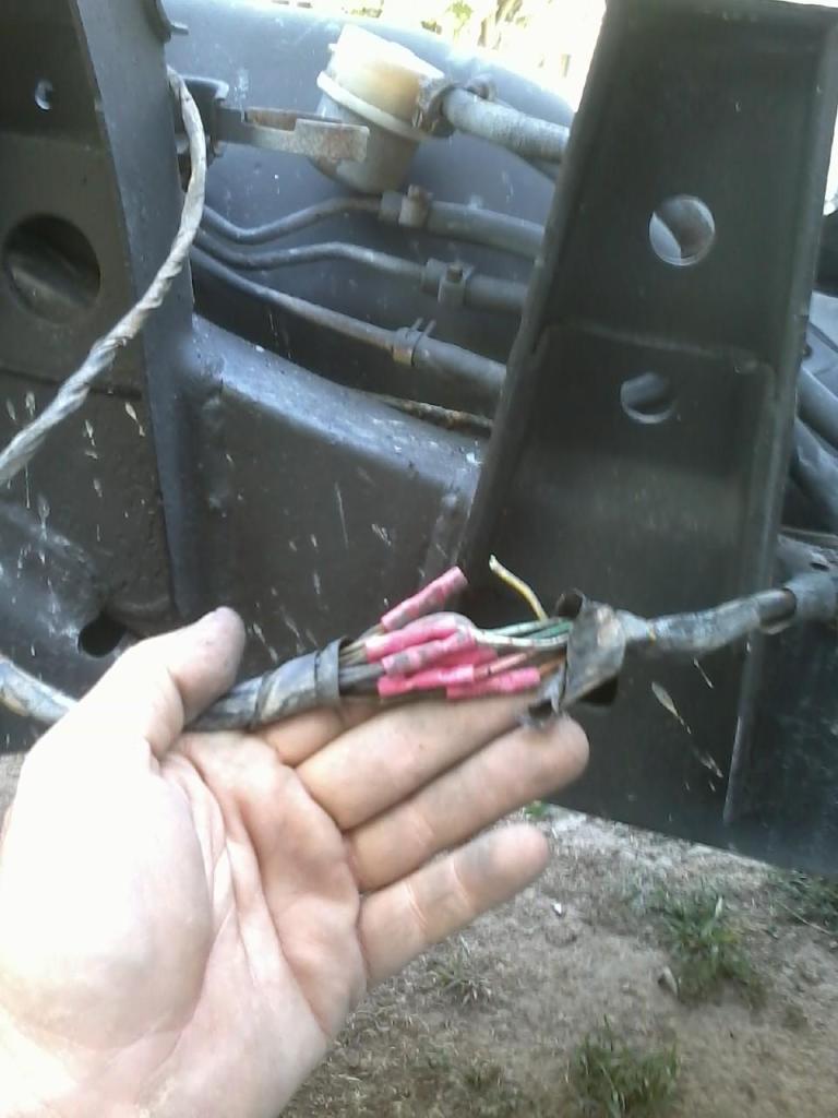

External 22r Filter.
I knew I had a picture of the factory filter somewhere. Ignore the wonderful wiring hack job.
