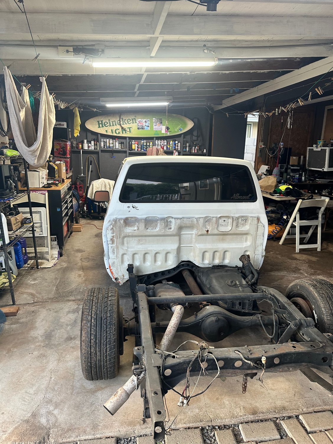

Glow shift says there is numerous ohm capabilities, I wanna try an ohm sweep on my sending unit. But the picture I have is when I was working on the truck. Bed is back on & the truck is black now. Project is finished only thing that doesn’t work is my fuel gauge. If my sending unit is still good I’ll probably get rid of the glow shift. Thanks for your help!🤙🏾
