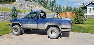

Hello, first, I've been lurking here for many months and decided to join. Thank you to everyone for sharing their pictures, experiences & tech help.
I currently working on my 4Runner and want to replace the sagging OEM mirrors. I've seen several pictures around the net where people have replaced them with the much sturdier truck-style mirrors. Are there any that work better than others? Is there a hole in the door that I will have to cover up?
I've attached a picture of my rig taken a week or two ago as an introduction.
Thanks in advance.
Attached Thumbnails 1986 4Runner: Replacement mirrors-20180720_131731.jpg
