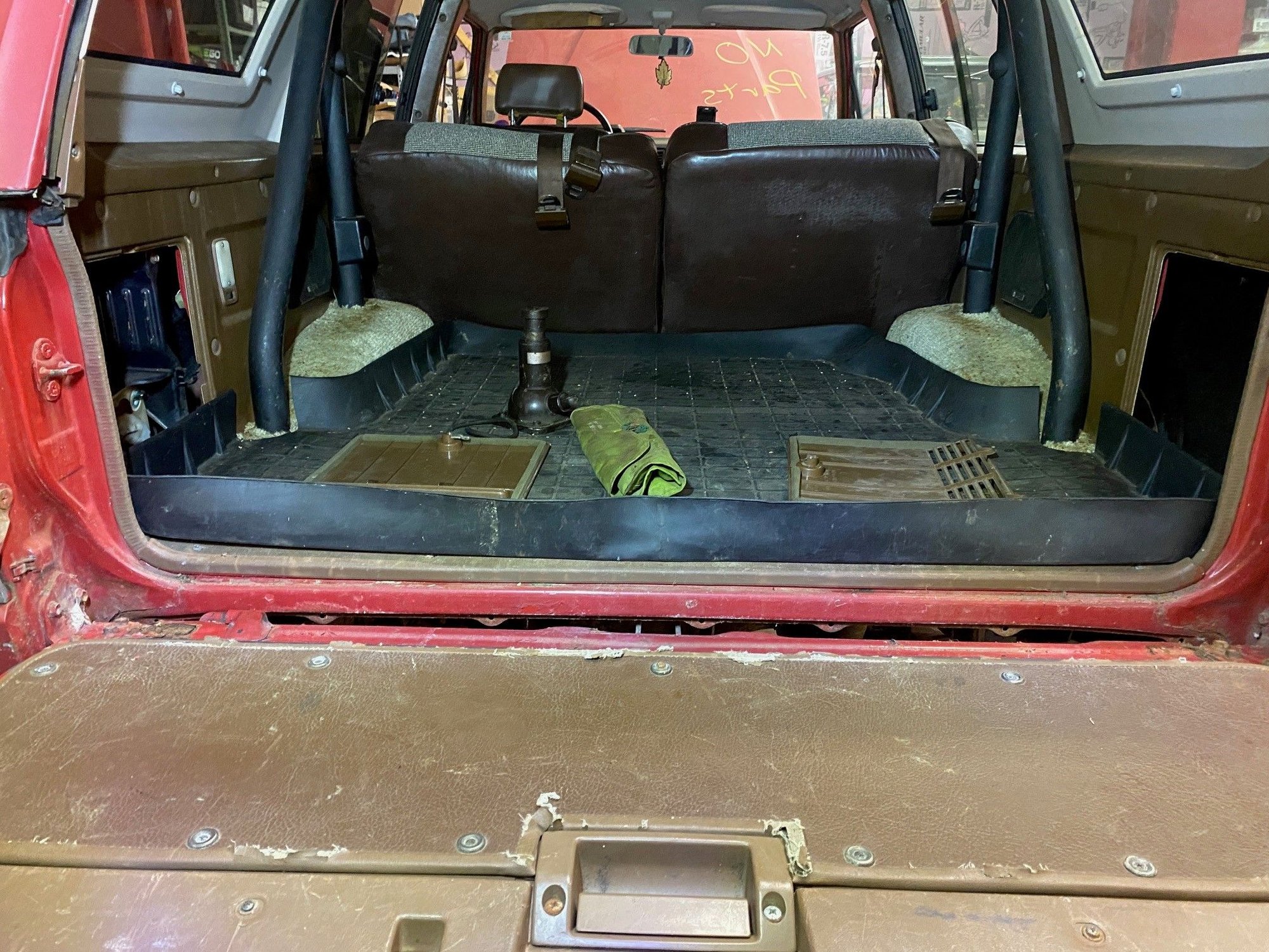

When I was 14 years old my sister and her husband pulled up in our front yard with a brand new 1986 Toyota 4x4 pickup, charcoal grey and chrome grille and I've loved Toyota trucks ever since. I think this was the same summer that Back to the Future came out, but I did not even remember that aspect of my obsession until just recently when I watched it again. What a brilliant marketing move by Toyota I thought! I even learned to drive a stick in that truck, when the BIL was too drunk to drive, and I was still 14 lol. Anyway, I've had a few Toyotas in the 35+ years since then but never the 84-88 pickup that I loved so much. As I got older (and bigger) I thought it would be just as good to own the same era 4Runner should the opportunity present itself.
I live in the middle of nowhere Wisconsin and this 4R popped up at a local junkyard, parked by the road (they don't crush classics, they say) for sale, for way too much money. Long story short (I hate long, wordy posts but hey it's my first) I kinda gave it a once-over after spending a couple hours in the yard on a Saturday. Did not even notice the ECU was gone! But the interior looked really good I thought and 95% of the rust was on the front fenders, which I figured was a much easier fix than the rear where I'd always seen it on other trucks of this era. A month or so later I made an offer they didn't accept, but the next day they dropped the price by $1,000. I made the same offer the next day and they accepted. It was probably a little more than it's worth to some people, but it was there, it was local and I've wanted one forever.
I crawled under that thing with a body hammer and beat all over that frame everywhere I could access and it was solid. Of course when I got it home and on the lift and removed the tank I found 4 spots about 6" or less. One spot was hidden by the tank and one on each side by the spare tire, the other I just plain missed! They've now been repaired. Will post more pics and questions (I have lots of them) shortly. Thanks for reading. Feel free to school me if there is a better way to post pics. -Jeff
Loading is much more fun with flat tires and no winch

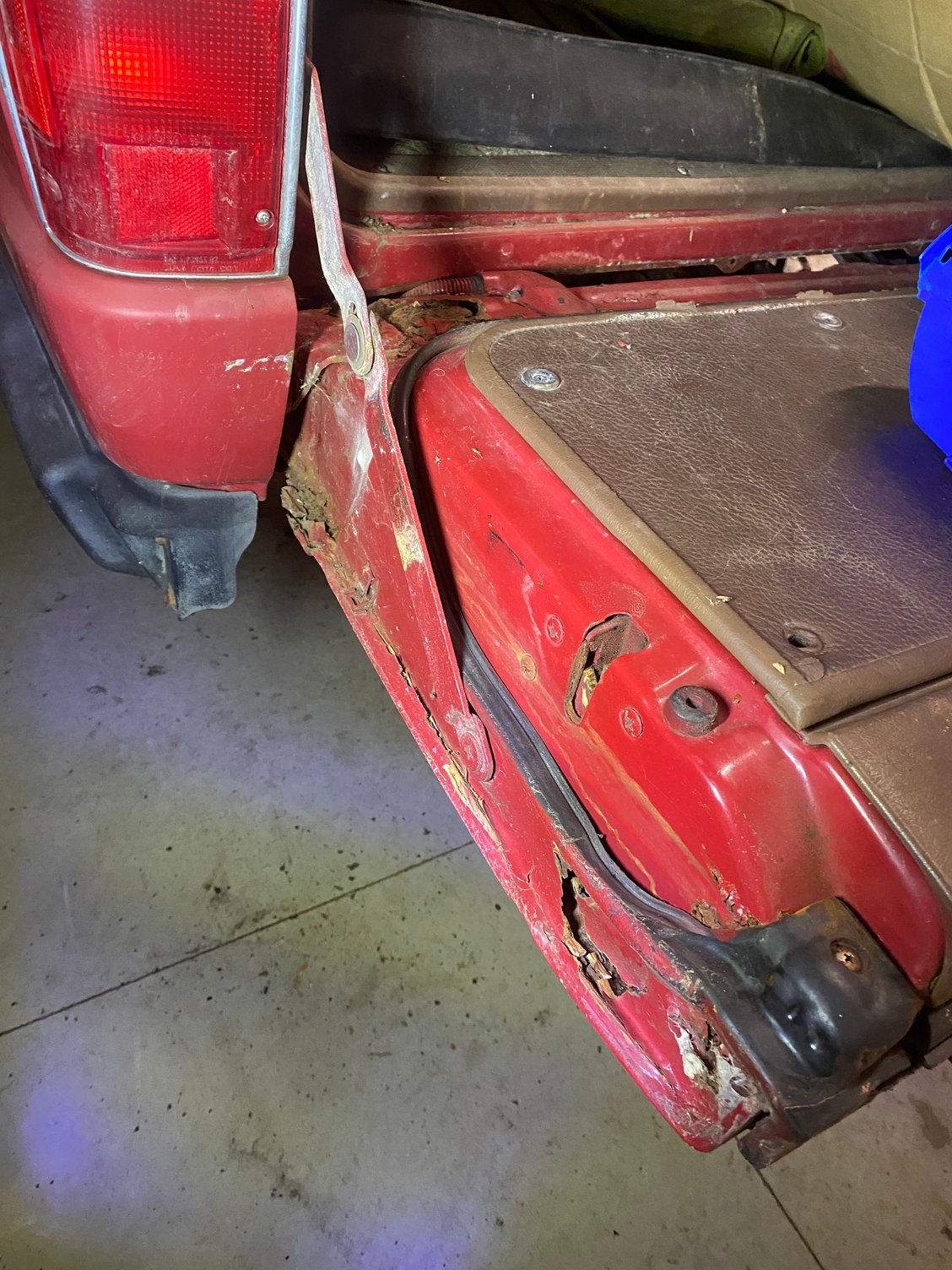

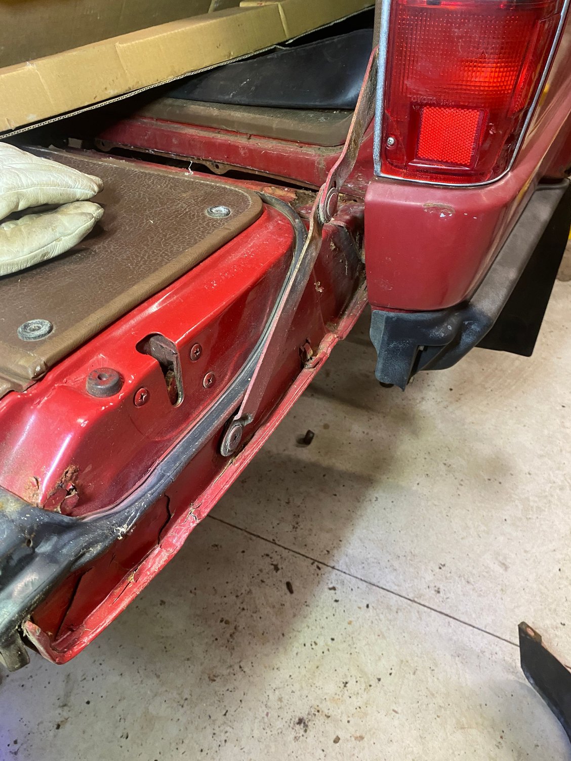

Looks great! Much better bodywise than my new project 87.
don’t even try to fix the front fenders. Repros are cheap.

Pics of undercarriage (rear lift arms have since been relocated to rear axle) Had to put the spare tire on drivers front before unloading it. I was able to lower the spare with no problem, it may even be original, date stamp indicates it was either produced in the 43rd week of 1981 or 1991 (September 1985 build)
One of the rust spots was right behind the LSPV, can't see it in the pic though. Also I think most of the leakage up front may be from the A/C compressor, it is covered in ?? and completely wet

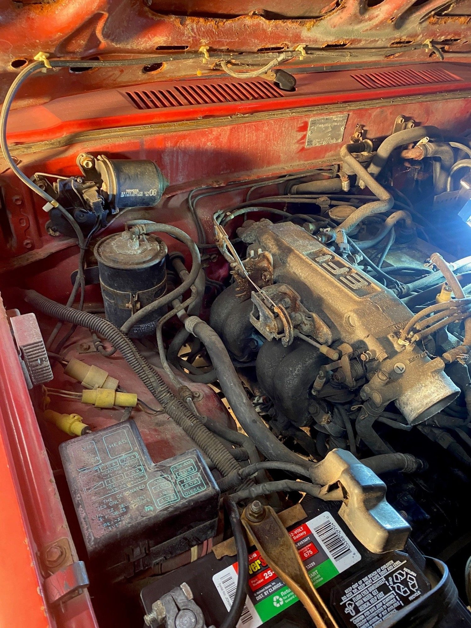

Here is where someone cut the AFM and brought it to the front desk of junkyard and tried to say it was from another Toyota pickup in the yard (94) he was asked to leave. Should be fun to wire back in!
Here you see a vacuum line disconnected and a fresh screw hole in the side of the intake. Can anyone tell me what part was stolen here? Also 2 more pics of engine bay if you guys see anything else missing let me know. I did pull the air box and it has a hole rusted through the bottom of it from all the crap and rodent feces that accumulated

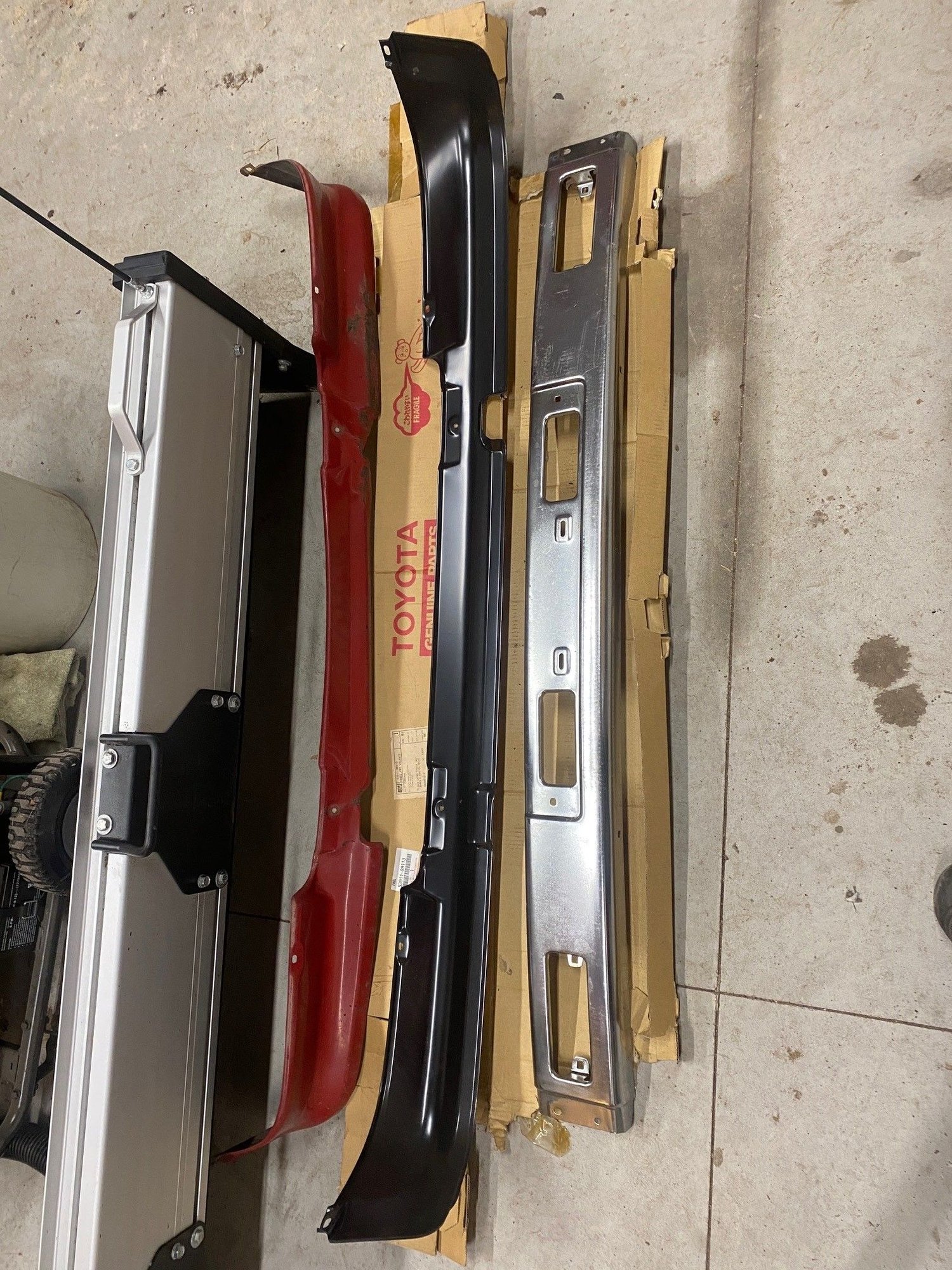

Scanning my wife's FB for fenders and bumpers and came across this deal, for $120 I got a new front lower valance, not-new-but-better bumper and a spare tailgate, which is better than mine on bottom but worse on top it seems, but it was pretty much a throw-in and complete so I took it. Guy had the parts in a barn for years. I like the guy on the box, I call him Fragile Man

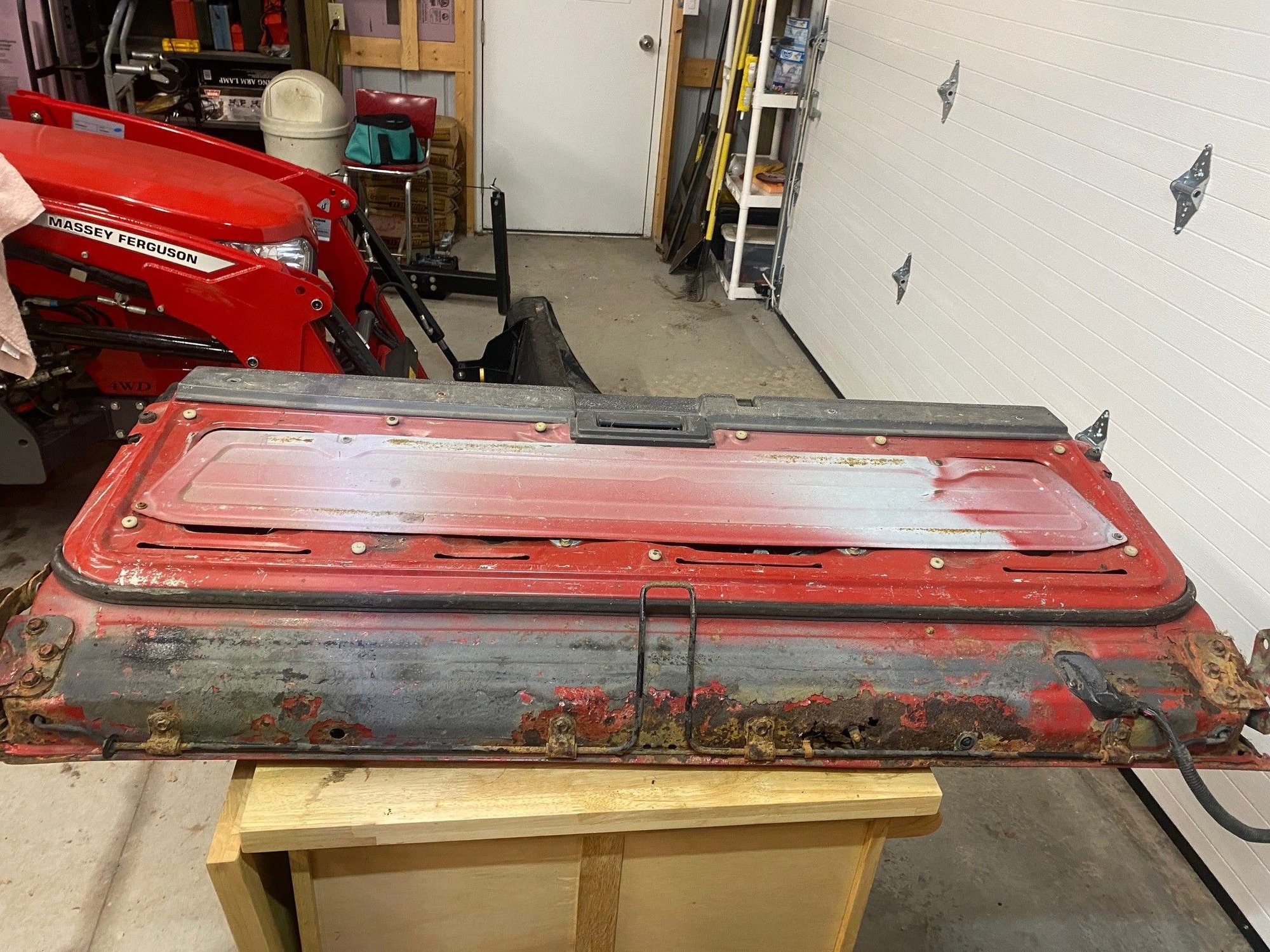

I finally decided to try the back window, mostly so I could open the tailgate, and it worked perfectly! Now have much easier access to the cargo area.

The missing item on the intake is the A/C idle up valve. No longer available but there is a post somewhere on this forum showing how to fit one off another model. Sorry no link right now.

newbie question, what's the rod across the bottom of the tailgate for?
A couple more pics of the hinges...
