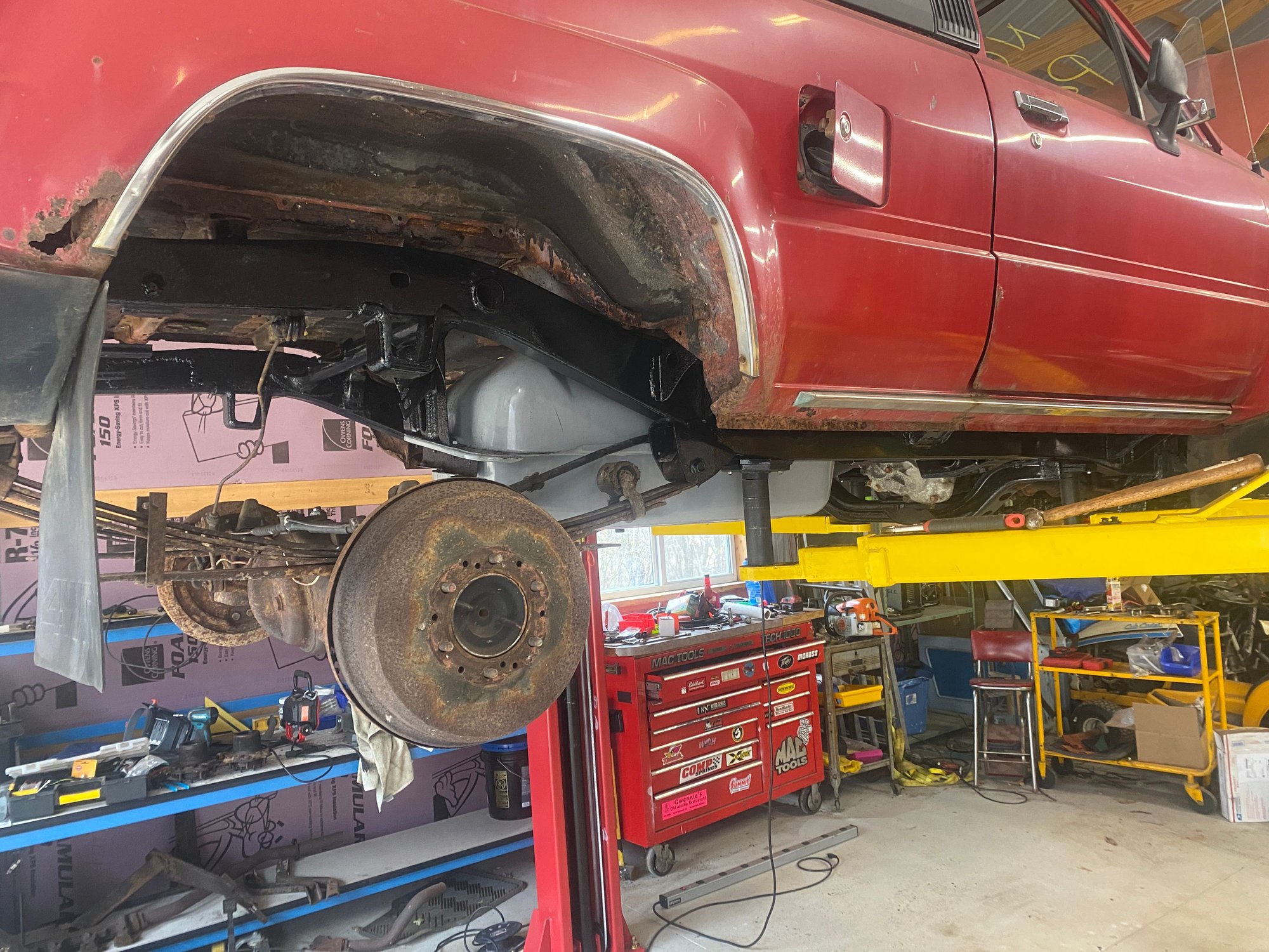

Love your work space....man a lift would just be incredible.

Thanks Cory, I waited 35 years for a lift, at the shop where I worked during my high school summers I helped them install a lift and I swore I'd have one someday lol. Now I just need to raise the garage door opener a foot or two, that's on my list

Get a wall mount opener, they are way cool
Yea I’m jelly of the lift also, I would love one but I’m far from having the space or
loot to do one.

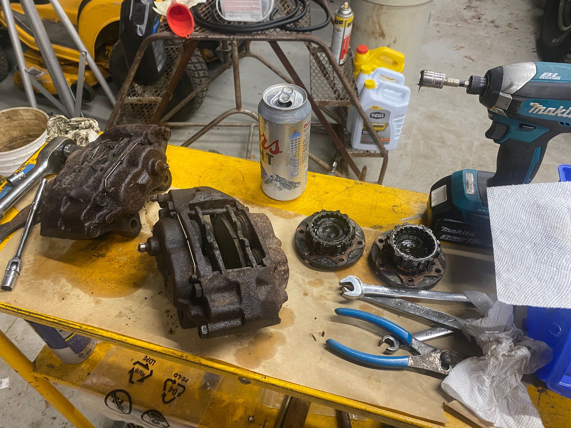

Next I am rebuilding the brake calipers, the kits I bought don't have the little o-rings that go between the caliper halves, so I guess I'll just have to find some. I am transitioning to 'while I'm at it' mode with the caliper rebuild and going to look into replacing the ball joints, tie rods, shocks and sway bar end links, which brings me to my next question...'

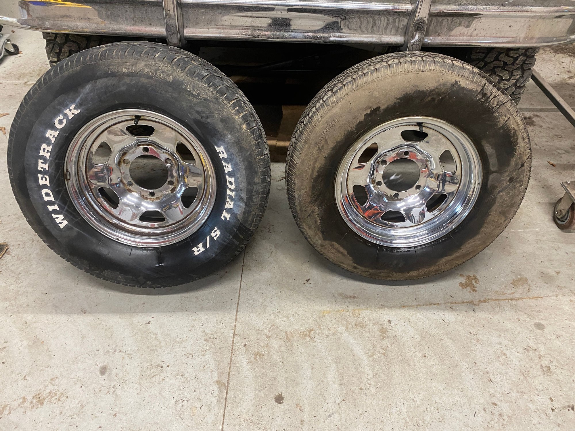

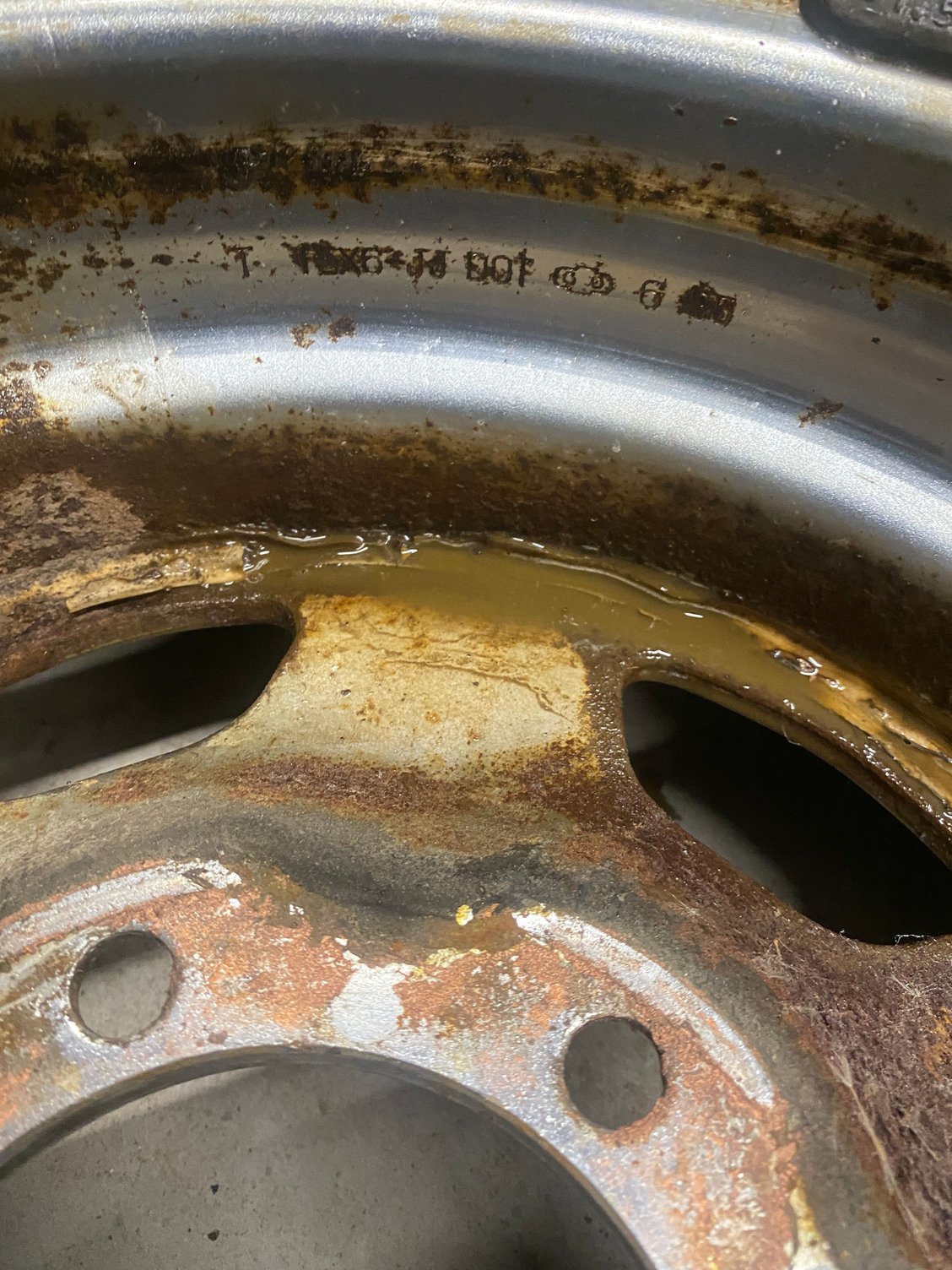

I want to do a very mild lift maybe 2" and I don't want to lift the IFS as I've read that it causes problems the more you lift it. I've read a little about ball joint spacers, so is there some kind of combination of new leaf springs and ball joint spacers + maybe a 1" body lift (since I'm replacing the body mounts anyway) that will accommodate and have a nice stance with 31" tires? Thinking 31x10.5 but don't want to throw too much rubber at this drivetrain. Staying with original wheels...which are cleaning up really nice! They are stamped 6/85 which further confirms my belief that they are original, 3 months before build date
these wheels look like they have some kind of seam sealer on the inside, don't recall seeing that before

after just a couple minutes with a 0000 steel wool pad and a spray bottle of water, not bad!

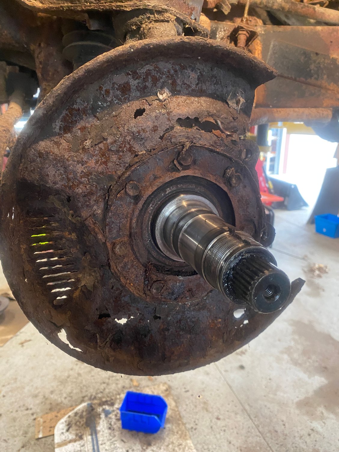

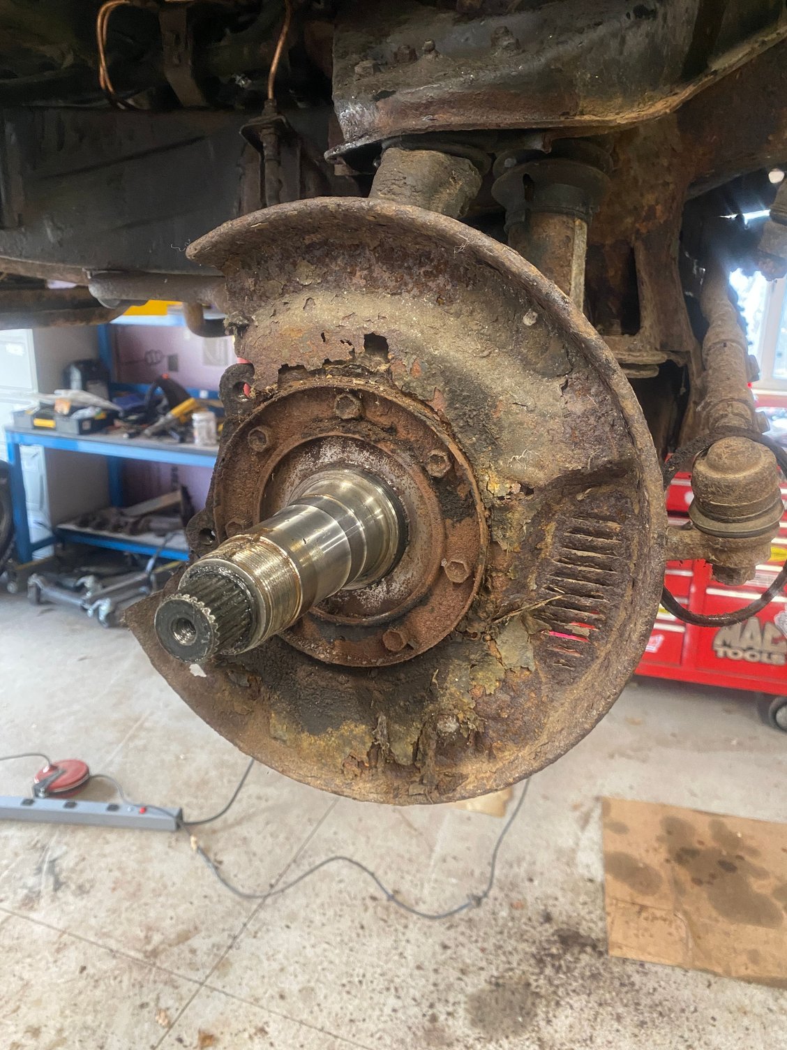

these backing plates are a rusted out mess, guessing they don't make new ones?

I have the same rusty backing plates. I checked Toyota parts deal, but they were discontinued. Should be pretty easy to get used. I saw a pair on ebay for about $75. My project truck has to show cooperation before i give it anymore gifts. https://www.ebay.com/itm/32541880987...mis&media=COPY

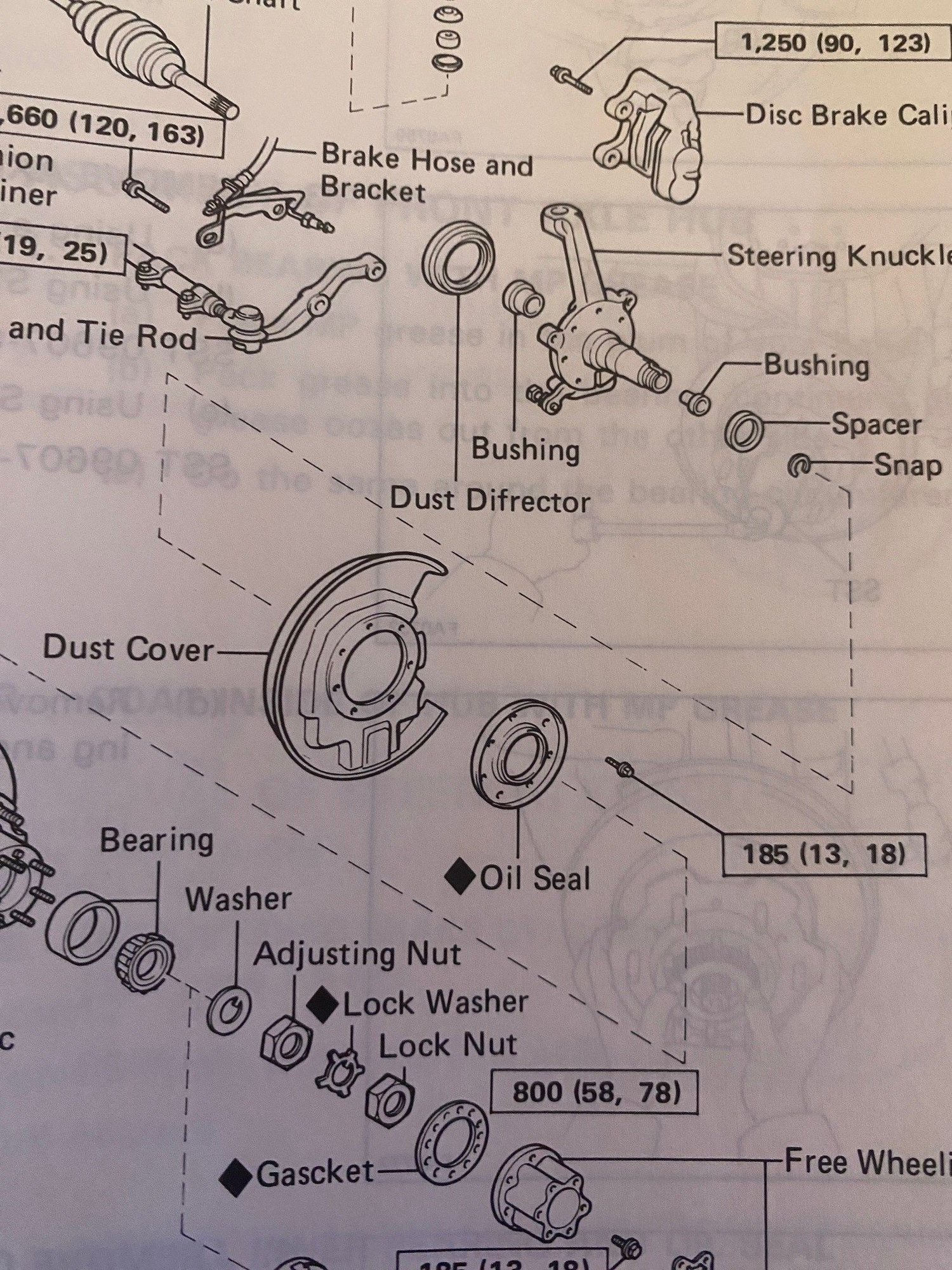

Thanks Melrose, my FSM says that ring is an oil seal and is not reusable, but the discontinued parts manual shows it as just part of the cover with no separate seal. So Idk maybe I'll leave it alone for now before I cause more problems.

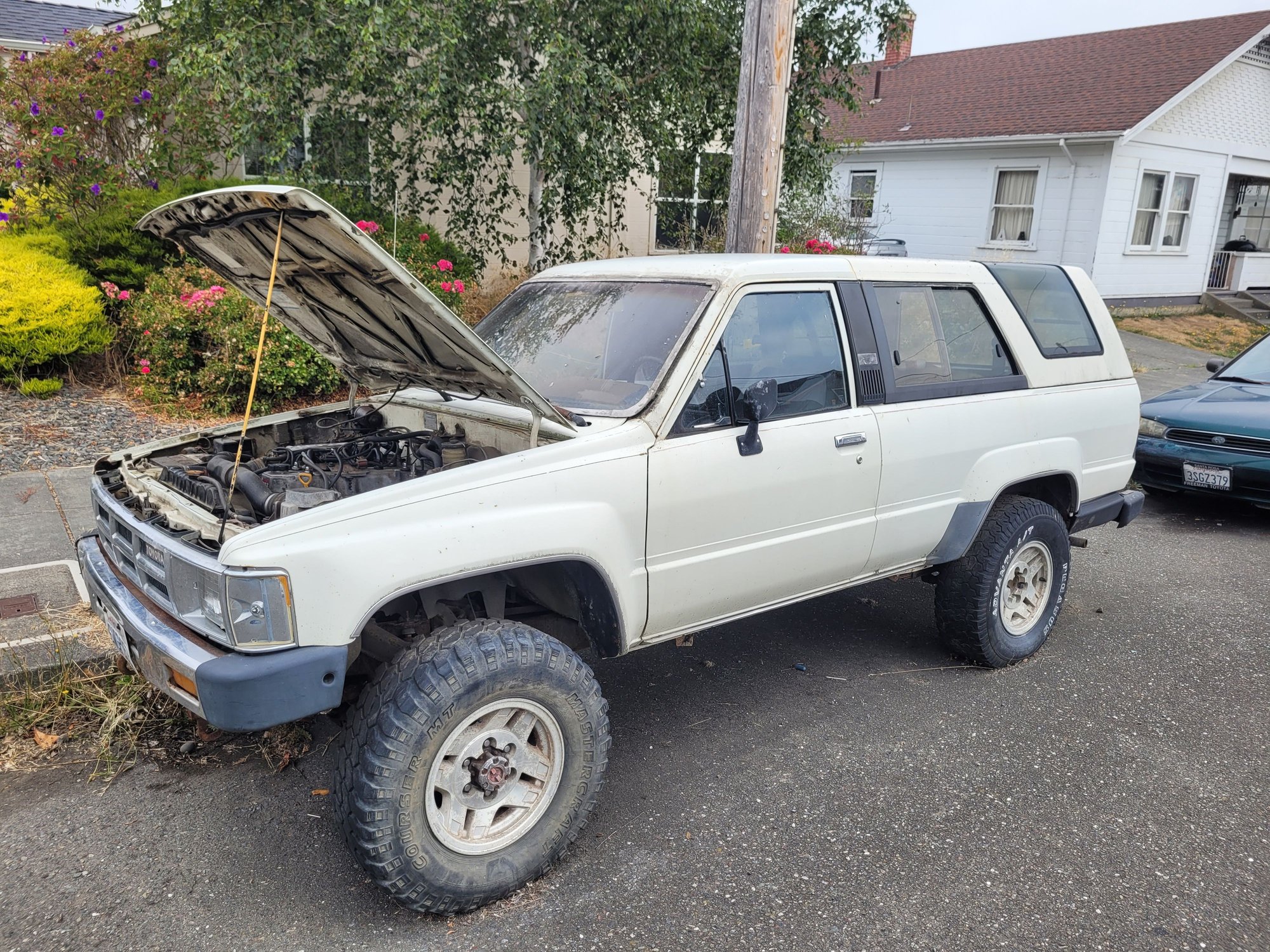

Meet Blanca and Rosa. I figure if I name em then she'll have to let me keep em! They both need a lot of work but it's part of the journey.

Very nice! Looks like even the California rigs can't escape the rust-magnet chrome trim! I am not looking forward to pulling my windshield trim

Oh the chrome... yeah it's pretty bad. Unfortunately, that's the least of my worries at the moment. I've got to get them drivable first. Rosa has a cracked exhaust pipe and a leaking timing chain cover. Both are easy enough to fix. Blanca on the other hand has more serious issues. If I can't get Blanca running right soon I'll probably pull the motor out of Rosa and put it in Blanca. I've invested so much time into Blanca though and I still can't figure out why she won't run right. It's driving me nuts. Haha!

1986 Toyota 4Runner Dust Cover
Toyota Parts Deal.com 4Runner Dust Cover
Old Mar 23, 2023 | 04:45 PM
  #59
hurricanes's Avatar
5 Year Member
Joined: Jan 2020
Posts: 168
Likes: 47

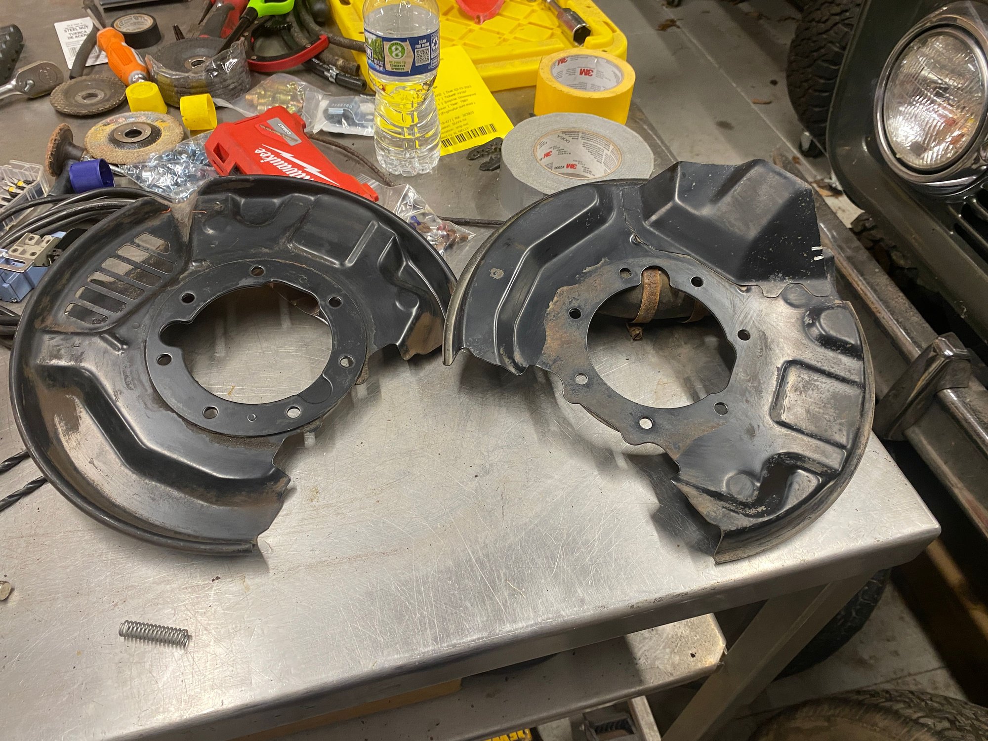

thanks for that, but it doesn't look like mine...if the drawing on the site means anything. It also says it's for 8/83 - 8/85 and mine was built 9/85. Kinda messed up that they advertise it as 86 but it only fits the first month of 86 production! It also says it fits when I enter all my vehicle info. I ordered those used ones off Ebay this morning

front disc dust covers I got off eBay are in amazing condition, and if I cared enough to clean them a little better they'd probably pass as new. Been spending ALOT of time brushing, scraping, cleaning and prepping the chassis for paint, got the first coat on yesterday. Every time I look in the mirror I see another Japanese rust flake somewhere on my face or neck haha
