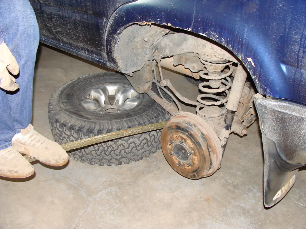

Ok, second time around only took 2.5 hours and got it done. Unhooker the brake hardlines on the axle to allow more droopp and help from a 210lbs friend on a 6' pry bar did the trick.
While I was at it, I removed the rear bumper completely in preperation for a custom job I am building. Well, turns out the mudflap was holding the quarter panel together Rust everywhere, 8" hole under the bumper.

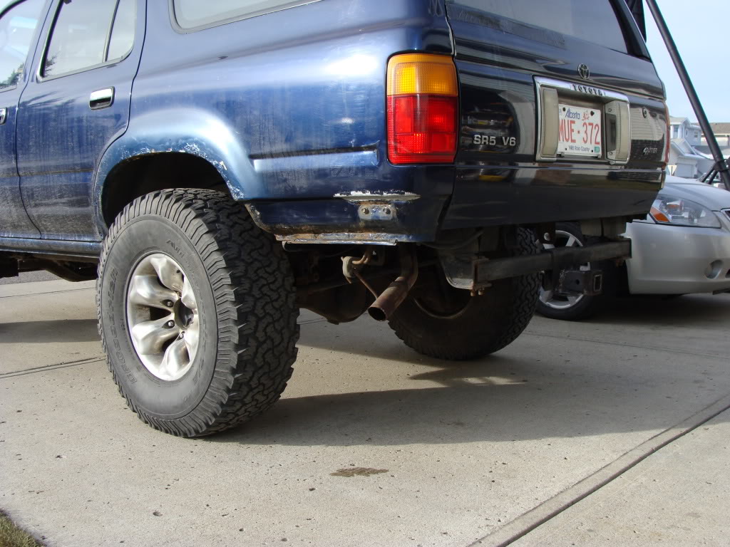

Before 1.25" DayStar spacer:

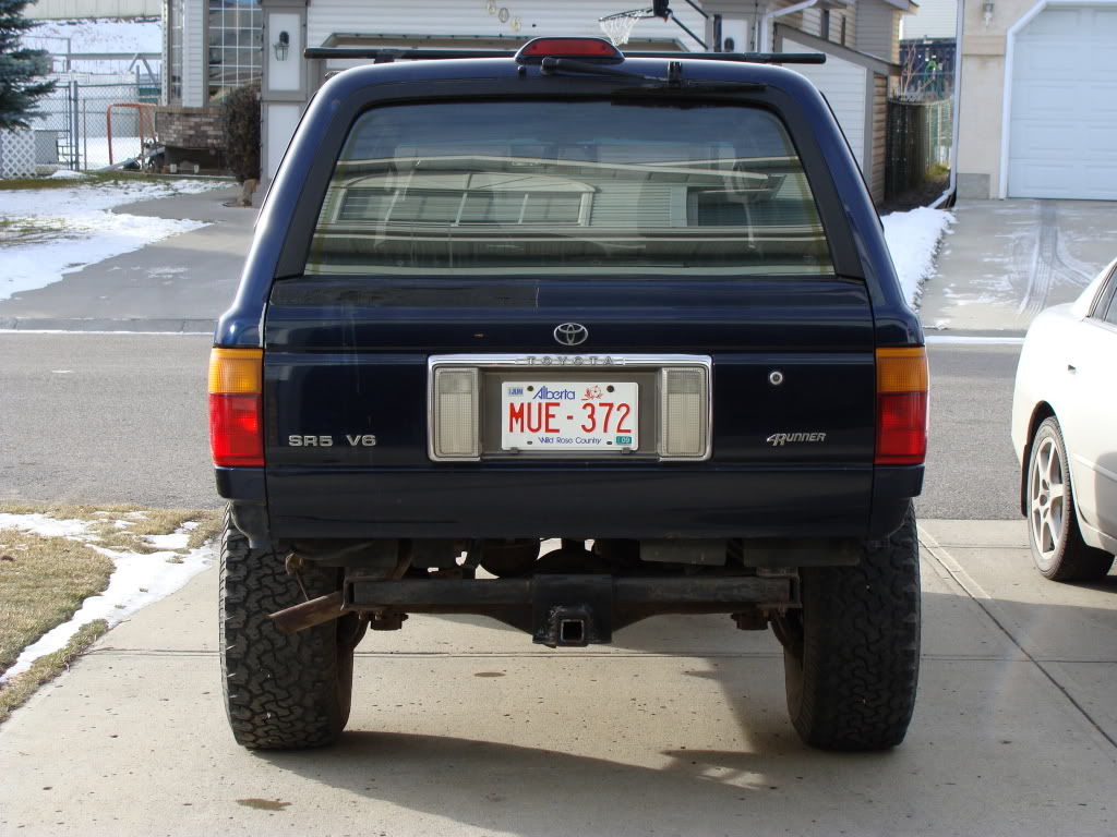

After spacer:

Undo shock, swaybar endlinks, parking brake cable (easier than it sounds, its behind the drum) then get a large friend to stand on the axle. Spring compressors help too.
