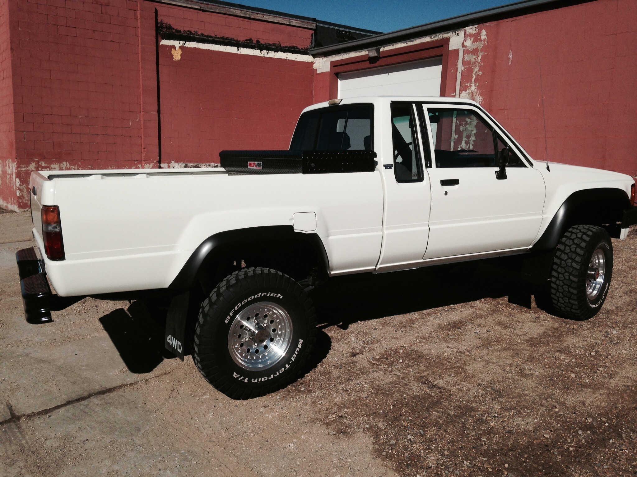

1985 Toyota truck
I have a 1985 Toyota deluxe with a 6 ft bed never modified. Just installed all sr5 interior.
Attached Thumbnails xtra cab bed box/ long bed possible?-image.jpg
