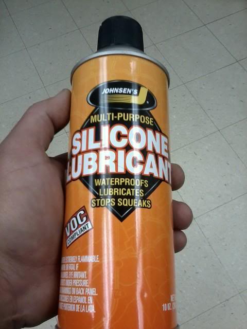

This stuff works great. Otherwise I hunt the yards for a good set. New door seals I get from Toyota or the ebay.

I'll give it a shot, but does it matter if mine only stick when it's wet out?
Thanks!
Old May 16, 2014 | 11:20 PM
RAD4Runner's Avatar
Joined: Mar 2012
Posts: 7,133
Likes: 684
Originally Posted by CamTom12
I'll give it a shot, but does it matter if mine only stick when it's wet out? Thanks!
Yep, dirt and water probably combine to make it stick.
I would clean seals as much as possible then apply the silicone.
Inspected and lubricated the gears on your regulator, too?

Did the silicone work for you?
Old Jun 7, 2014 | 07:01 AM
CamTom12's Avatar
Joined: May 2008
Posts: 523
Kinda. I didn't take the doors apart cause I was short on time, but I shot some of the stuff in the window tracks as a stop-gap until I can take them apart and do it right. Seems to work smoother, but not as good as if I'd have done it right the first time, I'm sure.
