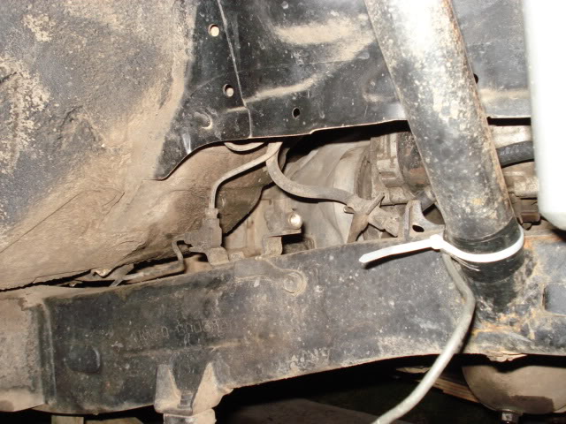

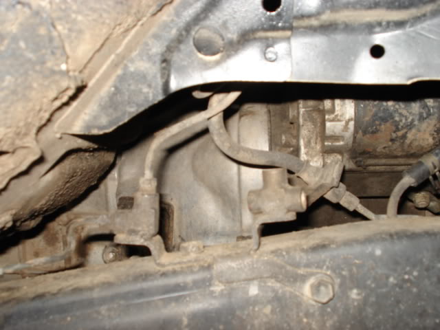

Starting in 1984 (the year of my truck) Toyota added a secondary return brake line that I actually don't know what it does, but it's part of the original proportioning valve. This line can be removed completely. You will see where it Ts off on the passenger side frame rail. Just cut and remove as much of this line as possible. If you want to "professionally" remove all the line you will have to lift the cab off the frame, which I wasn't about to do. What you want to achieve is one direct line running from the master cylinder to the rear axle, and one line from the master to the front axle. Now, of course, these lines will be split into left and right wheels (discs front, drums rear). The T for the rear split is on the axle, and the T for the front split is just below the master cylinder. Here's a few pics of how I chose to bypass the secondary return line. You can see that my rear line is attached to the frame with the L fitting on the left, and my front, right brake line completely bypasses the stock T fitting all together and runs straight into the caliper, it's zip tied to the shock hoop. This is much easier once you get into it.
