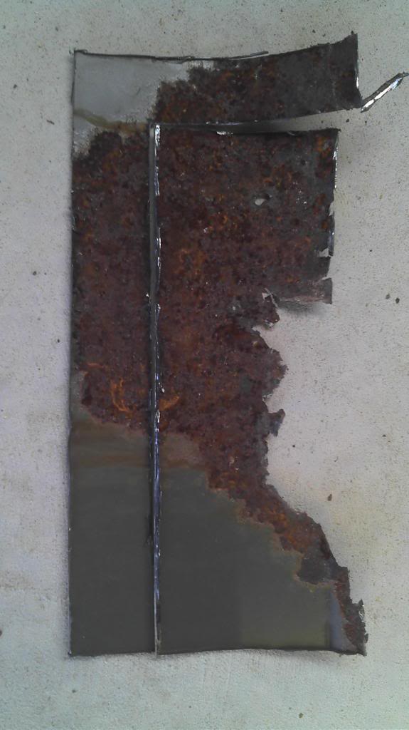

Ive done a bit of rust repaire on my rocker panel before
I used .6mm welding wire , my main advice would just practice on some metal same tickness before hand its pretty thin , and just make sure you dont get it to hot or it could warp the panels
This is the sections i cut out

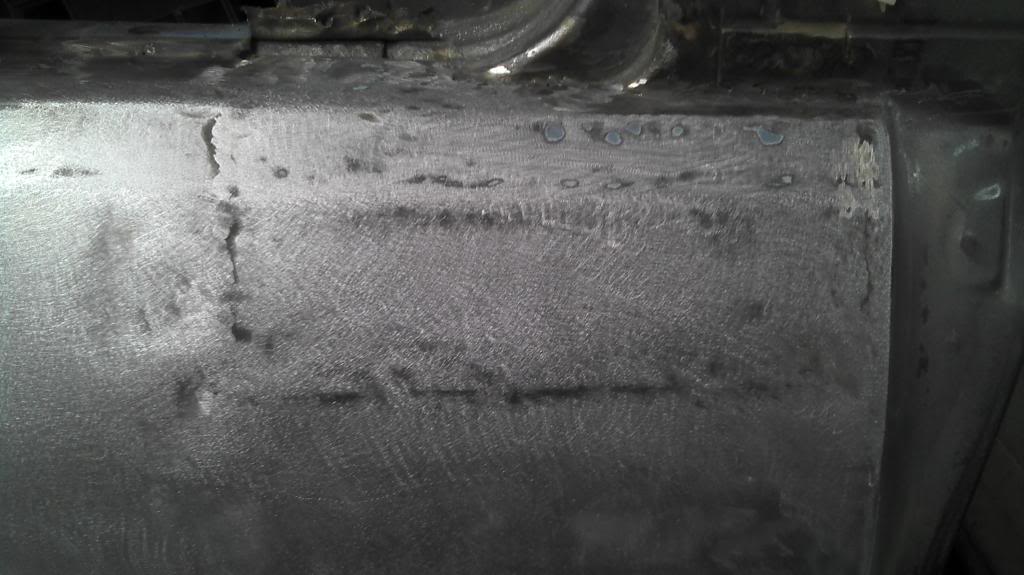

This is the patch panel i made from an old door i had lying around
After welding , before grinding back
Im sorry i dont have any pics of the finished product
