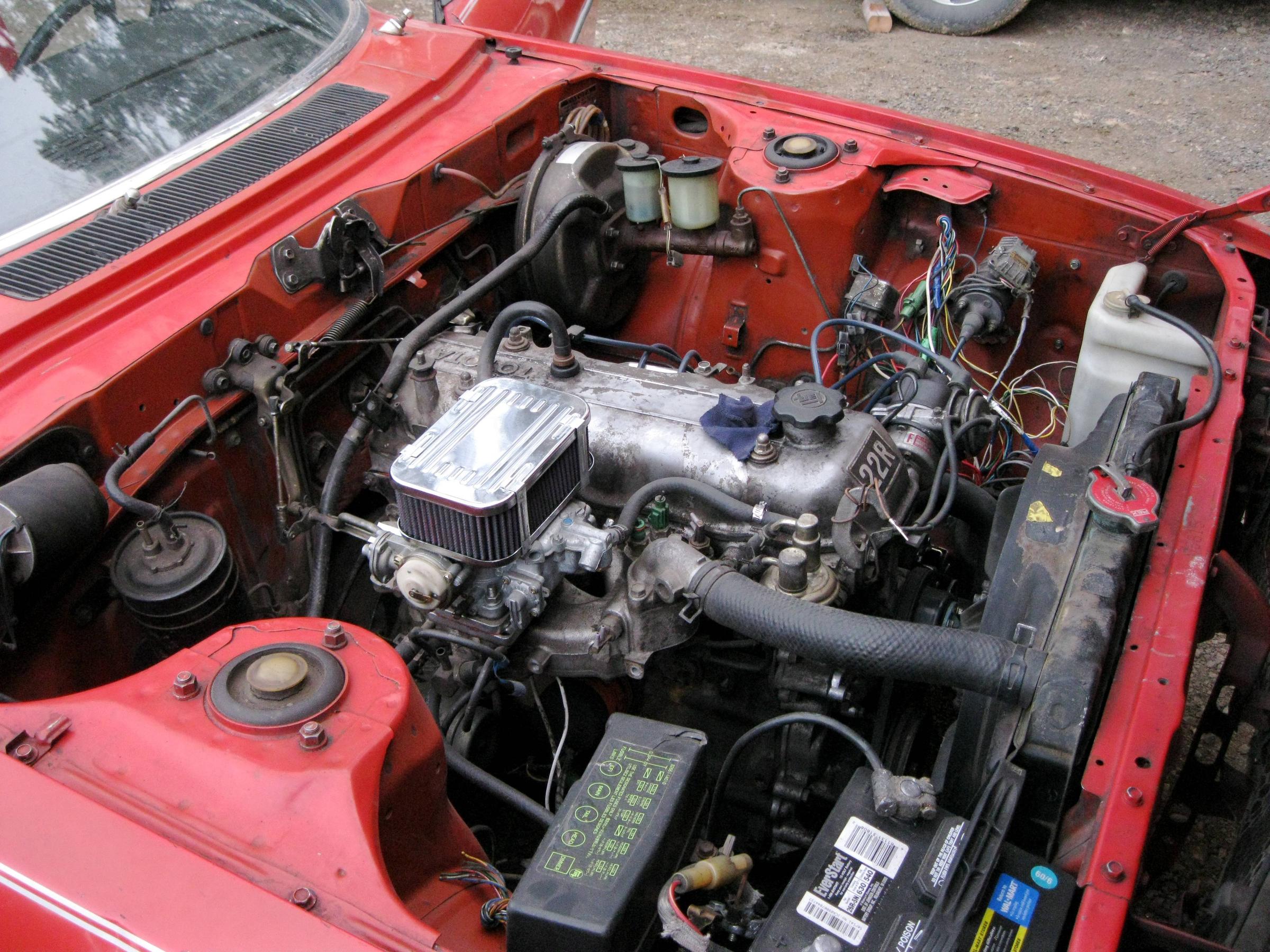

Do you have a picture of what you are talking about? This is a picture of a 38/38 installed in my old celica if that helps at all. Might have to zoom in on it.

Yours actually doesn't have one haha. I talked to Fred at Weber he told me that it's an over flow vent. If i kept my smog equipment on that would plug to a charcoal canister

Float bowl vent.. I had to mod mine to keep it from flooding on steep inclines.
Huh, cool. Well enjoy your 38. I sold my car pretty quick after I got all the vacuum leaks plugged, but it was a super reliable starter and I liked the electric choke a lot. Really gave the 22r a decent amount of power, but you could hear it sucking fuel from inside the cab
