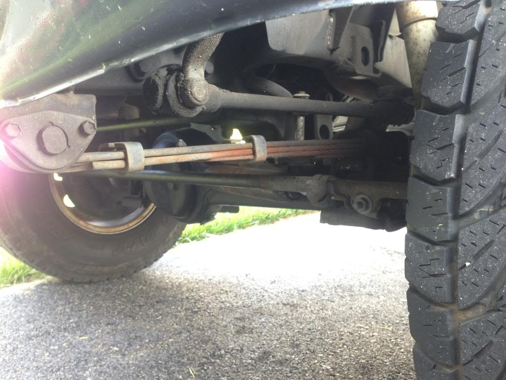

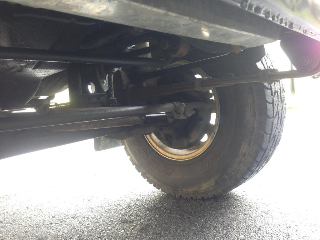

So my truck has had wandering steering since I got it, also super saggy springs.
This is a thread about those effects vs. wandering steering in the solid axle trucks and what I end up doing about it.
First off, here's what I'm working with:
In the experience of the members here, is this enough sag to cause enough caster issues to cause wandering in my steering? I've not done any other troubleshooting yet, just been driving it. The wandering's not terrible, but if it was late on the weekend I'd be worried about getting targeted for DUI, haha.

Get old man emu springs. Factory fit but an 1.5" lift. And much less per corner

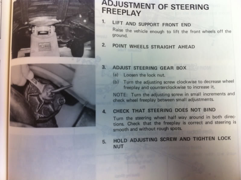

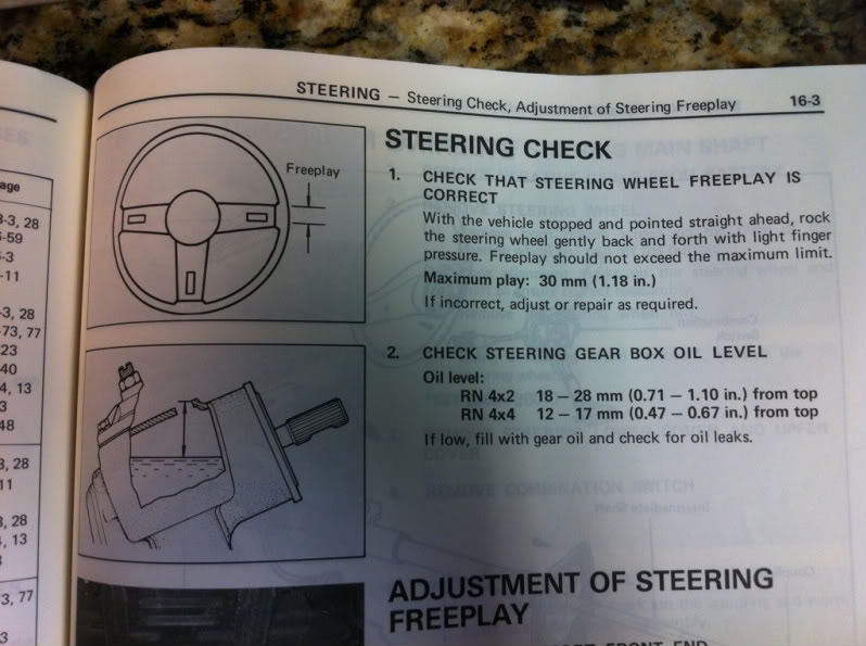

posted this to your question in my build thread--
I used another push pull power steering box, a dropped drag link and a steering shaft with rag joints that were in much better shape than i had previously.
there is a way to tighten the steering box slightly, not a cure all but it can help alleviate some issues

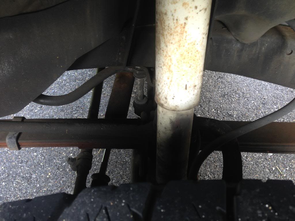

New Tie Rod Ends, Trunnion bearings and new wheel bearings etc can help wandering issues. steering stablizer good?
What kind of shape is your front end in? after rebuilding mine it was like a new truck.
Converting to high steer was probably the best bang for the buck improvement i have made to my truck over the years

I've adjusted the steering box on my '00 F250, it looks like an identical procedure so I'll try that also.

Your springs look pretty normal for factory springs. And I've heard several times that the springs are even slightly inverted when new. So I don't think the springs are contributing to your issue.

Yes, stock front springs are different on the right and left. I believe it's because the spring perches on the SFA are slightly different heights but I could have been told that and it's total b.s. I have seen some aftermarket spring companys talking about how the "other guys" give you the same RT and LT springs, but that they "do it right, unlike their competitors" and make separate RT and LT springs.

Ok, well that's good news at least. So for now I'm going to tidy up the steering and replace some worn components in the front end (trunions and wheel bearings) and hope that fixes it.
I'll keep saving for the 3" lift to get hi-steer in the future. It'd be nice to do that all at once.

i would start off easy first... put the front end on jackstands, and see if there is vertical play in front wheel bearings... there should be very little to none... also evaluate tie rod ends, and particularly the factory pitman arm(?) setup, i understand that those wear out pretty quickly.
wandering down the road can be caused by a toe-in adjustment that's wrong... the 4crawler site tells you how to measure that, but i didn't find it very effective, once i had my rig on the ground, after adjusting it, i had to tweak the toe-in even more than the factory measurements indicated, and it still wanders.

So I made the terrible mistake of pricing out a new steering stabilizer, tie rod ends, drag link rebuild kit (all Moog) and a pair of new U-joints on rock auto. About $100.
Should I pull the trigger and burn a weeks allowance in the budget or just let it ride as it sits?
If crossover steering is anywhere in your near future, don't bother. If you're going to have the stock setup for a while, then new rod ends and a fresh drag link rebuild will make a huge difference in your steering. I wouldn't bother with the stabilizer, I haven't had a working stablizer since I've owned my current truck and I don't miss it.
