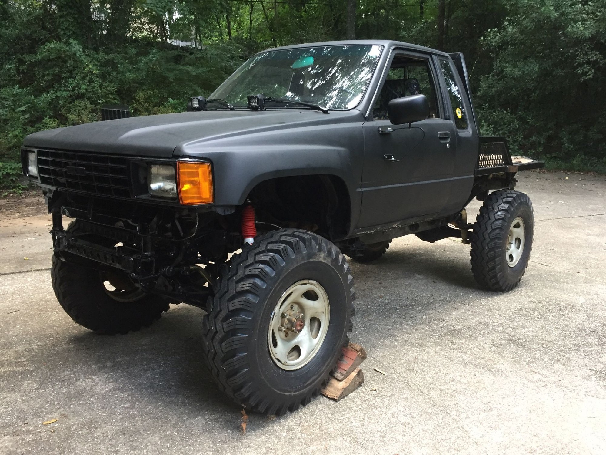

I assume what has happened is someone had the carb off and they lost the bushing. I pretty much have saved this truck from the crusher. Cut the rust out of it, Patched all the floor pans and made a woods truck out of it. Flat bed, lift, 36 inch tires, lockers, flat black rattle can paint, etc.
What it looked like before.... the remants of a car smash fundraiser. Completely trashed. Here is what I'm working with now:
