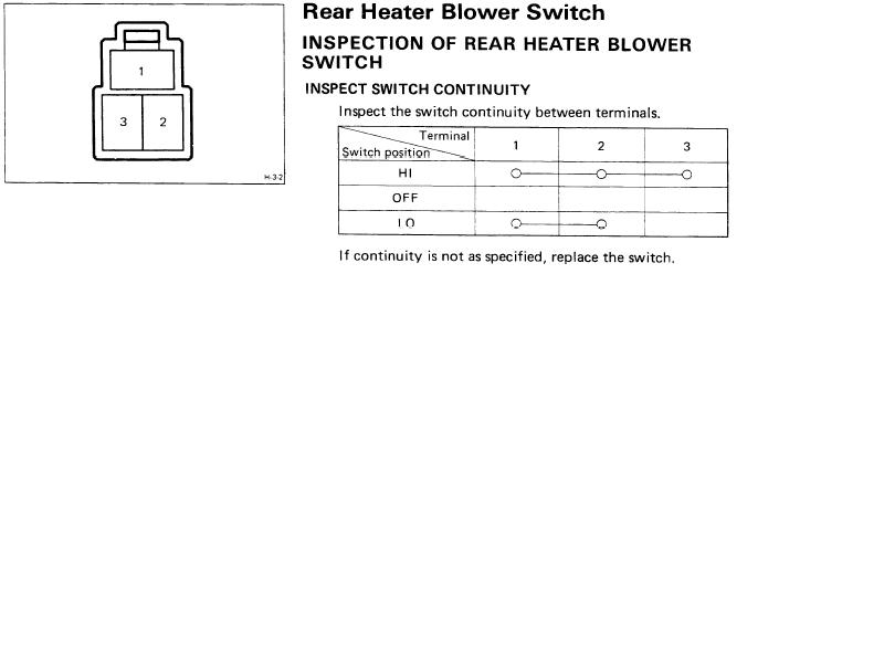

on my 86 the relay is to the left of the glove box cavity. If you have the glove box out you should have very easy access to it. (assuming yours is the same) you can feel the relay click when you turn the heater on. if the heater works in lower modes then I would say the relay is good. could be the switch in the dash since it doesn't work well on high. the contacts could be corroded inside the switch. on mine the high setting is a direct 12v through the switch.(bypasses the resistor) yours is probably a 3 speed switch right?

Yeah, it is a 3 speed. My entire dash is apart b/c I had to remove the heater core, which is why I'm addressing these problems now. I'll take a closer look at it. Thanks.
