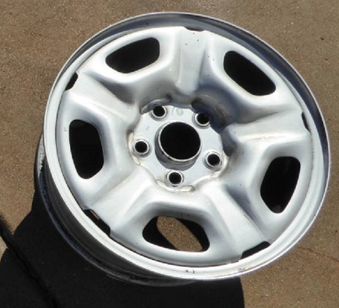

Will Tacoma wheels (like the one in the pic) fit on an 84 Pickup? Far as I know the bolt pattern is the same but I'm wondering about the center hole.
Thank you

Tape measure. I would think they would but I haven't tried on a 2WD myself.

Just one lil problem . . . I don’t have one of those wheels to measure.

My resource for a 2004 Tacoma 2WD wheel shows the center bore to be 67mm on that wheel and the bolt pattern to be 5 X 114.3mm. Check out this link for more info.
https://www.wheel-size.com/size/toyota/tacoma/2004/

Thank you, the specs for the pickup are the same

The wheels will fit no problem, I had 3rd gen 4Runner wheels on my 85 Xtra-Cab but, the back spacing on Taco-Runner wheels is too deep which narrows the track too much so use wheel spacers and get to tracking wider on OEM rims.

How thick of a spacer did you use?

"2 up front, 1" out back because I have a 3" wider 87 rear axle.
Now I have rattle can black old school steel wheels that used to be chrome with a better off set but, I still have 1" spacers up front.
