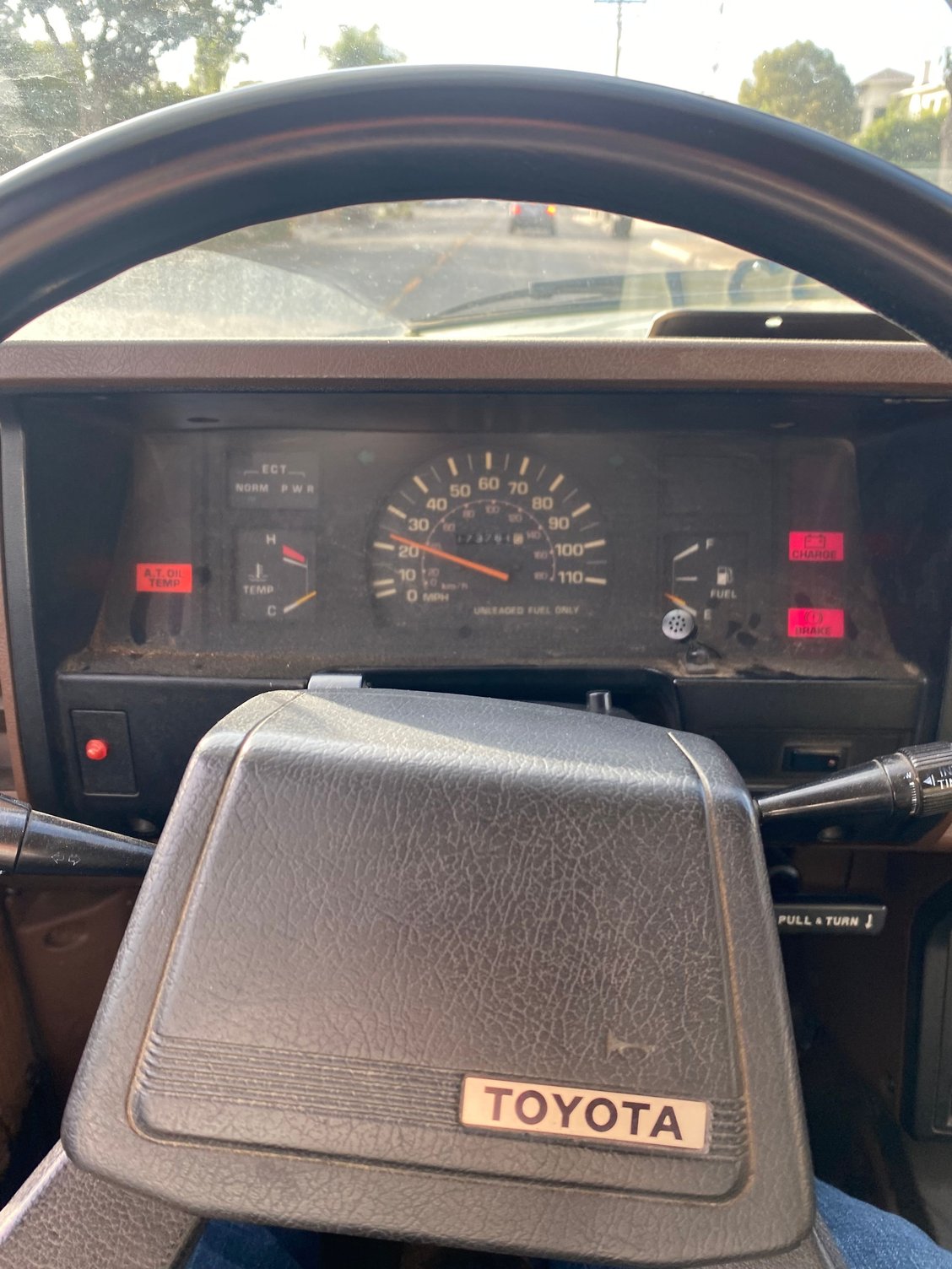

I’ve been having this problem that has only happened once before and happened again today. all three lights came on in my truck and nothing happened but they stayed on for a while and kind of felt like I had a slight loss of power but don’t really know? Anyone if you know the solution to my problem. Much appreciated

Alternator hiccup??
Check the alternator brushes for wear.
