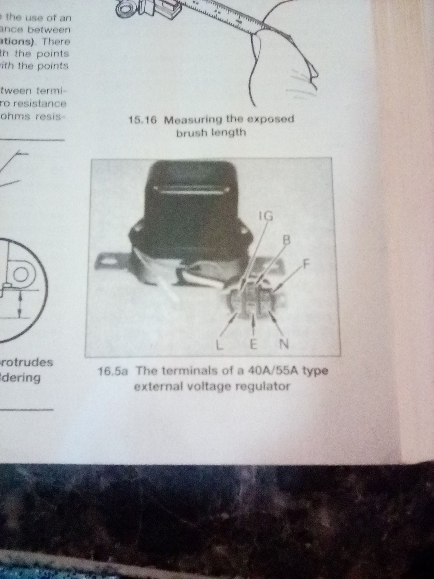

I found a Pinout
It turns out in the Haynes manual there is a photo of a pinout for the six pin voltage regulator,
​​​​​​The last pin I have not figured out to use is the one labeled as L in the photo, any leads as to where this goes?
