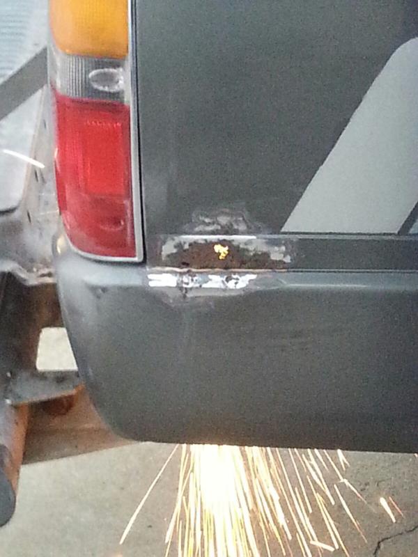

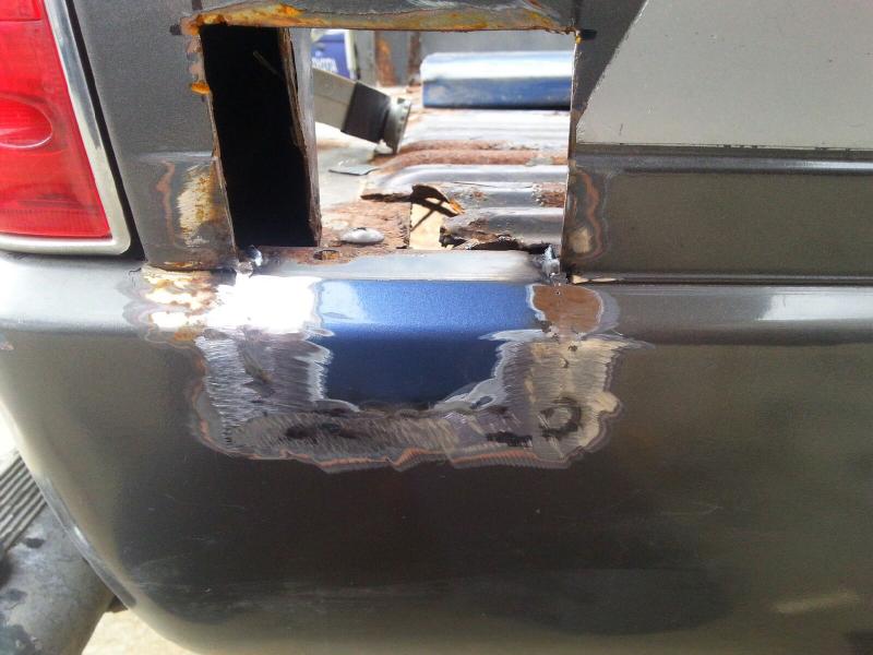

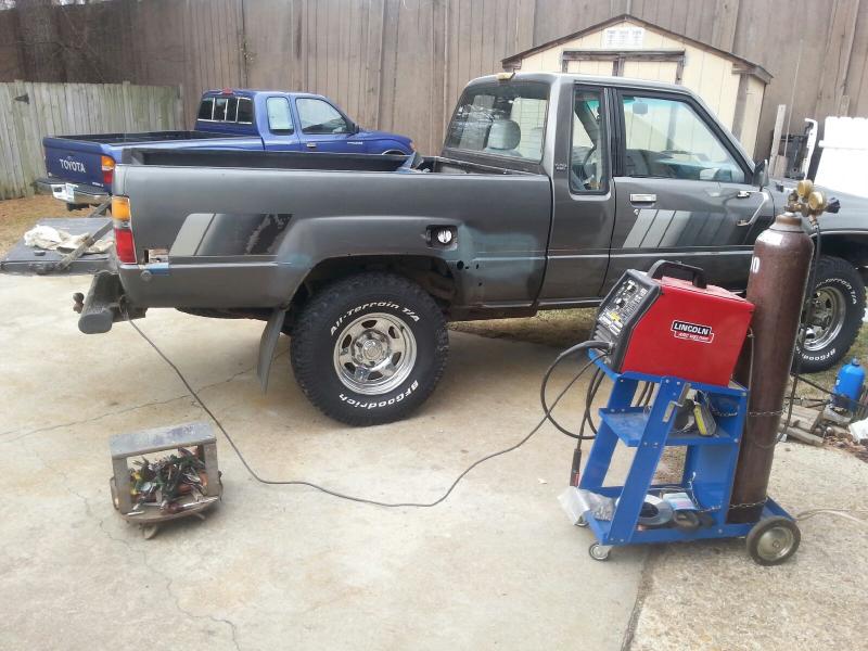

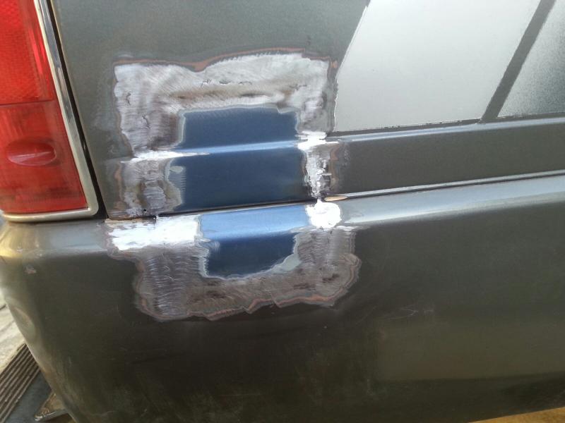

I was able to get a few hours work in. 3 hrs yesterday on the lower patch and 4 hrs today on the upper. Working outside temps right at freezing and a 8-12 mph wind (not good for gas shield mig welding).

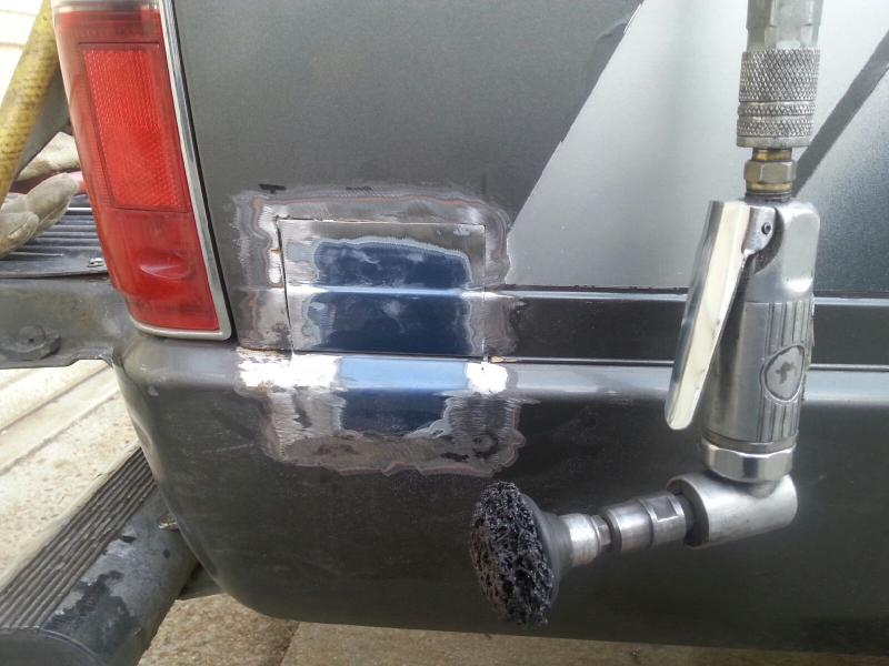

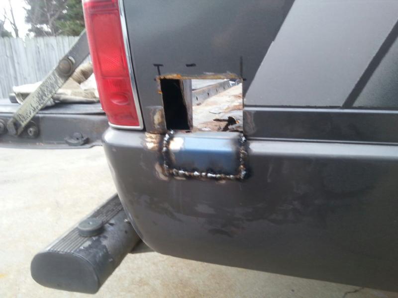

Upper patch fitted into cut out. This is the most time consuming part. A good friend who does production work says he cuts his patches with a Plazma cutter. Place the patch over the hole and cut both the patch and panel at the same time / same cut. I'm stuck using tin snips and a hand file ~ but it works.
splurged and bought (2) cans of primer. 1 SEM self etching and one Upol weld through. $52.16 OUCH. Not sure they are worth it but I figured I'd give them a try. Just needs to warm up a bit / temps below freezing next few days.
Next up is drivers side front of bed.... Ugggh
