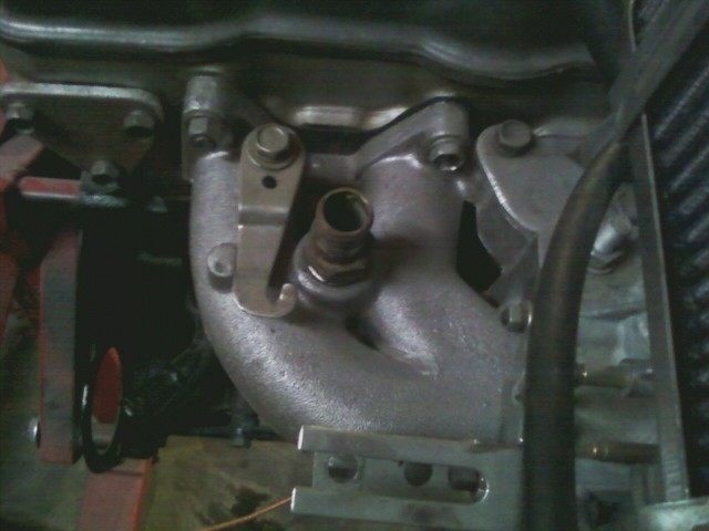

I've also got a photo here and it's different than my 22r head (20r head). Not quite sure what goes here? Looks like the water temp is on the radiator hose connection that you can see in the photo. Any ideas? I'm sure I'll have a couple more questions along the way as well. I'll post up photos of the whole project once I get some more time and get it driving again.

Thanks for the input. Any suggestions on what goes in the empty spot in the photo?

empty holes
I believe that hole is for a vacum source, power brakes etc. I cannot tell from the pic if it is where coolant flows or not. If coolant does flow there, it is for a temp operated switch, of what funtion would only be a guess. That's a weber style intake I'm not as familiar with.
Watch out for those empty holes. The last yota I replaced an engine in (purchased as a basket case w/new engine in the bed) had an empty hole on the back side of the block... It was an oil galley plug. The rebuilder did not put the plug back in, I should have noticed it, and ended up having to remove the transmission to find this mysterious "oil dump."
Take your time, to look over and double check everything, especially if this engine was sourced, ie you did not build it yourself. You might save yourself some time.

Ok.... so I took a closer look at it to answer the question of if it was a water passageway or not. It definitely is. I can see the thermostat through the hole. I think I'm going to find a plug that will close it off until I determine if I need it or now.
Any have any ideas on what size it may be? Maybe 3/8 npt would work as a plug.

Yeah, I looked at an old intake this afternoon and it is just plugged off. I'm not sure of the size, but If you run into a road block I can send you the plug out of the intake I have. I'm on the Right coast, so it won't come swiftly... Just let me know.

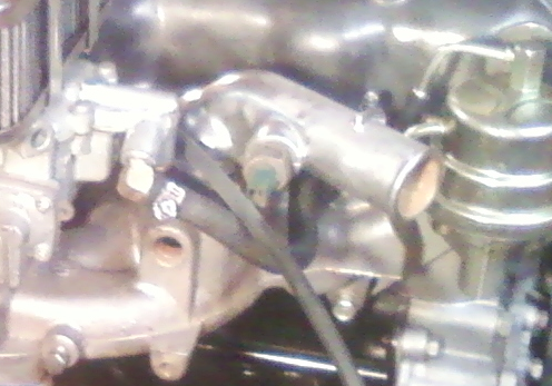

another quick question. What is this? It looks like another water way connection, but to what? If that is it. There are the two hard pipes that come out of the "back" of the timing chain covers that go into and out of the heater core. Am I missing something?
There are two for the heater core and two for the radiator (very obvious).
EDIT: for those just catchin up, it i a 22r block w/a 20r head.
