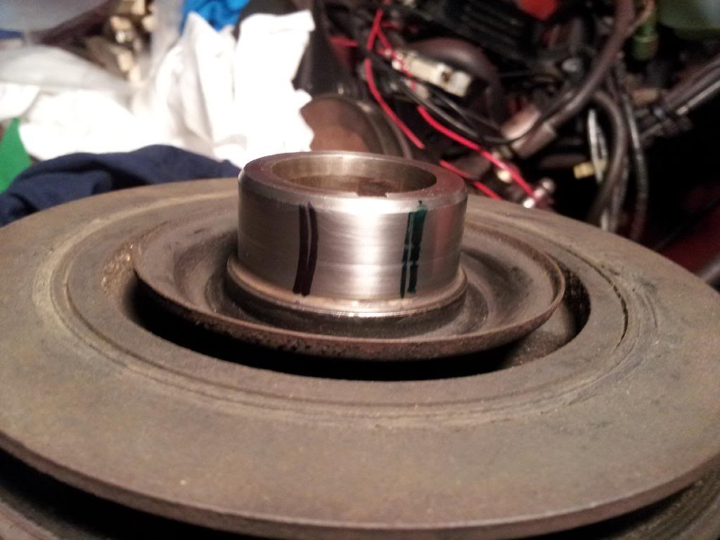

take a sharpie(or other permanent marker) and color a thick stripe on the pulley perpendicular to the groove. with the new seal installed on the oil pump push the pulley straight into its location, then turn the pulley back and fourth a few times then remove. you should see two clear wear marks thru the marker line you made. If either line is on the groove get a different oil seal. That's what i did. My parts stores are usually manned by idiots i wouldn't/don't trust.

I wanted to update this thread because it was a help to me in checking new seal vs old groove clearance.
My sharpie lines:
Upon closer inspection:
My new seal misses the current groove by .075", nearly 2mm. I still need to add the paper gaskets for the timing cover, so that will move my new seal .020" closer to the old groove, so I'll still miss the groove. An extra seal came with the engnbldr kit, but I'm not swapping seals around at this point.

Holy cow! You needed a different seal for that little groove? I've just replaced seals with new factory ones, on deeper grooves than that, and not had any leaks. Granted, I do try to put the seal riding in a different area by going deeper or shallower in the seal recess...

Good, I'm glad to hear my groove isn't bad. This is the only one I've seen,so I have no frame of reference. This fitup just used the seal already installed into the oil pump I got with the Engnbldr kit. I'm glad to hear it looks like I'll be leak free.

Keep in mind the manufacturers such as Toyota, have changed the part number and discontinue old seals so new seals are made to contact in different places to avoid hitting the same groove.
