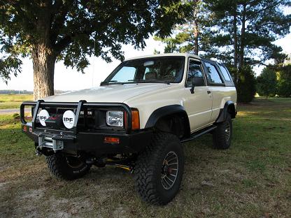

2 1/2" OME lift with springs, shackles, greasable pins, U-bolts, and shocks. Heavy front springs, medium rear and heavy shocks all around. Lift is more like 3"+. The only problem that I had was that even with the special flattened OME U-bolts on the driver's side front, the draglink still hit the U-bolts and I had to install a Procomp drop draglink. Very happy with the ride on and off road.
Attached Thumbnails Show off your suspension lift-side-view-small.jpg   Show off your suspension lift-front-corner-small-2.jpg

ooh love that runner
