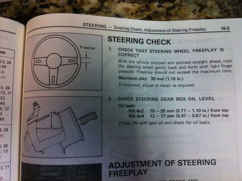

on the steering box there is a provision to tighten the box slightly.

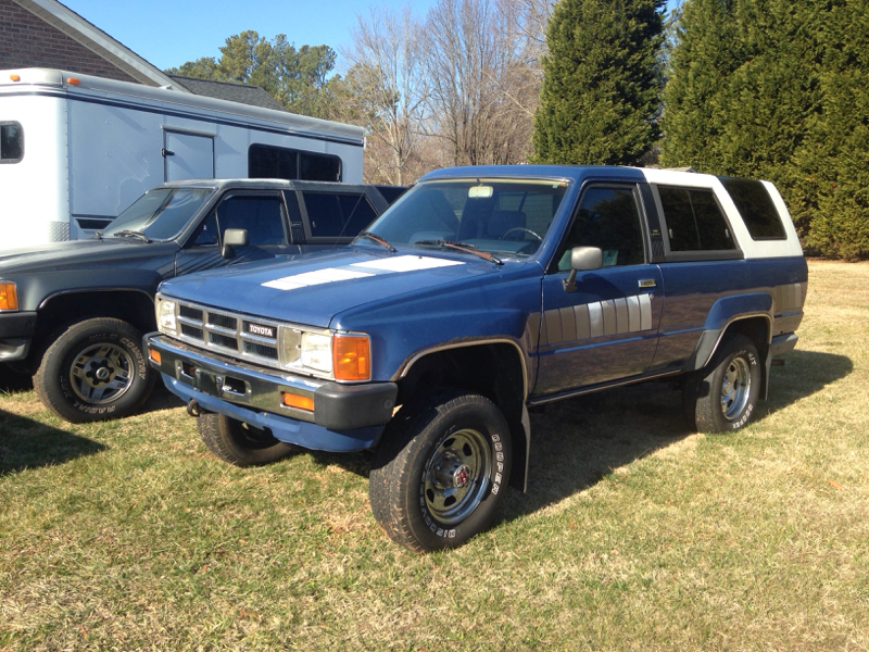

Well I'll have to do this one photo at a time for some reason.

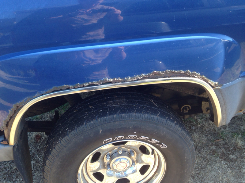

Fender

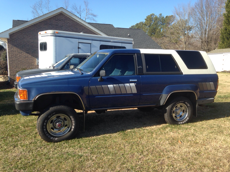

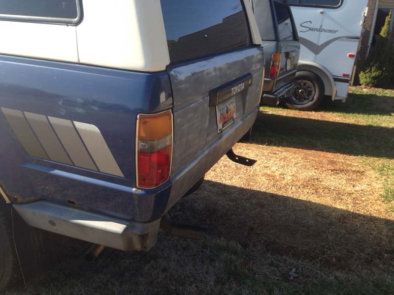

Rear needs love
Attached Thumbnails Returning an 85 to its Former Glory-image-3912372258.jpg

Classic rust
Attached Thumbnails Returning an 85 to its Former Glory-image-2681390539.jpg

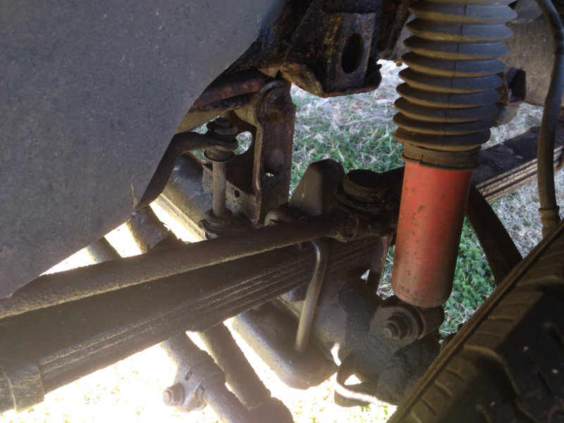

Front left leaf
Attached Thumbnails Returning an 85 to its Former Glory-image-2675662172.jpg

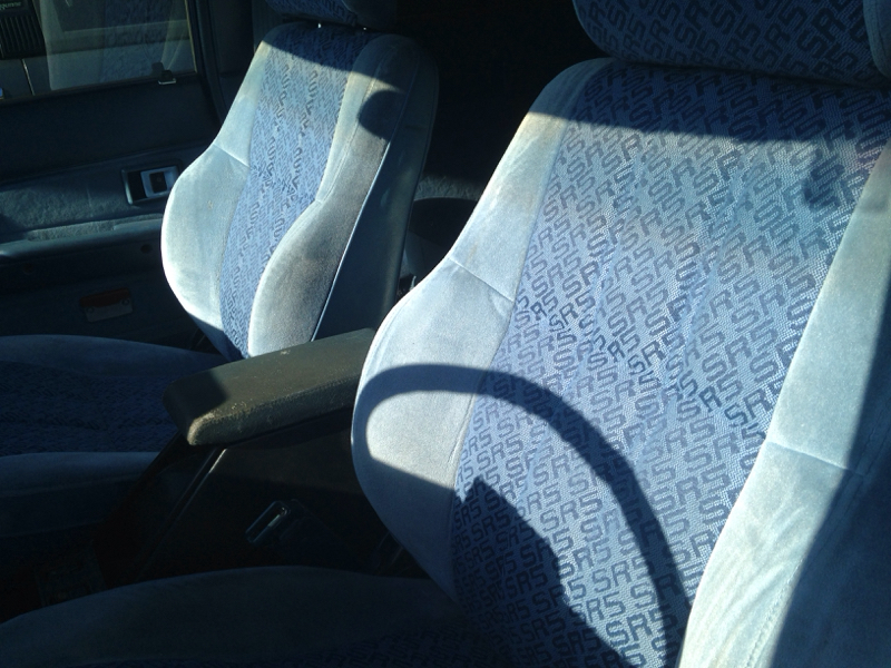

Vertigo seats FTW

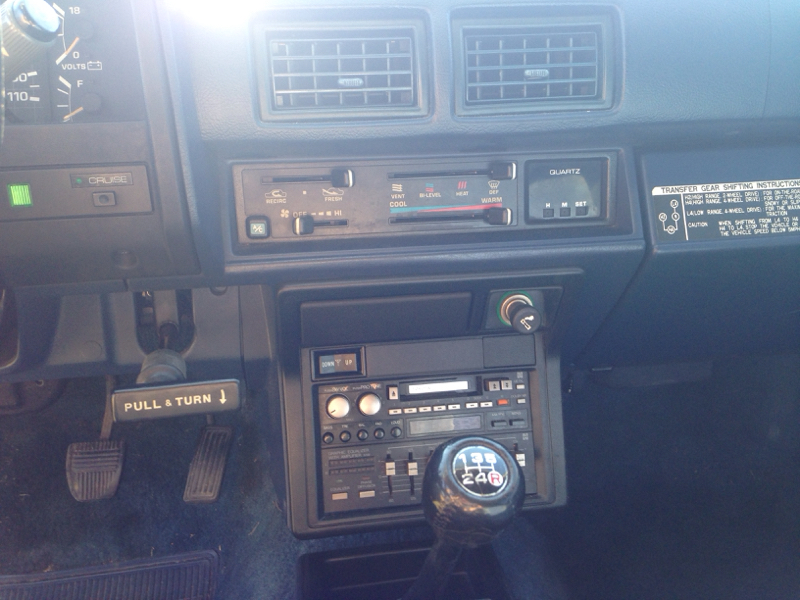

Bezel intact and 80s radio
Attached Thumbnails Returning an 85 to its Former Glory-image-3684548779.jpg

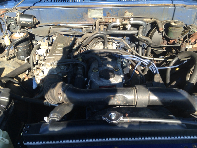

From: High Point, NC
Motor...recently rebuit

Nice find!

Nice, a little body work and set of springs and she'll treat you right for 30 more years.

That is a nice truck you have. I always have liked the vertigo seats. I also like the chrome trim on the fenders but it is a rust magnet. Looking forward to your build.
