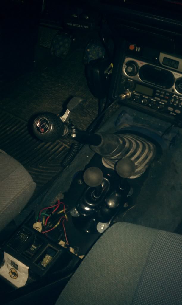

So I just ordered new gears for my transfer case through Advance Adapters (since Marlin doesn't seem to want to stock them anymore) as well as a new crossmember through BudBuilt. I figure while I have the case out and apart this would be a good opportunity to add in a dual stick as well. Marlin doesn't have their unit in stock, so I've found two different sellers and was wondering if anybody had any opinions on which was the better unit.
The first unit is through Trail Gear: http://www.trail-gear.com/twin-shifter
The second unit is through Front Range Fabrication: http://frontrangeoffroadfab.com/nfos...products_id=36
If anybody has any experience with either of these and would care to offer any advice it would be greatly appreciated!

I've used both, not a fan of the TG one. It's really bulky and overly large for the job it has to do.
I have the FROR twin stick in my rig. The shifters are rod and are easily bent into whatever position for clearance you need. IIRC, thus twin stick isn't as tall as the TG one.
Both were easy to install.

Thanx! I was leaning towards the Front Range kit, and that pushed me over the edge.

I ordered the FROF twin stick kit over the weekend and going to grab a couple of springs from the wabbit tonight. BigBlue, thanks for the advice and the pic, and hopefully my truck will look pretty similar by the end of the month!

I think you'll be happy with it. Just be careful bending them.
