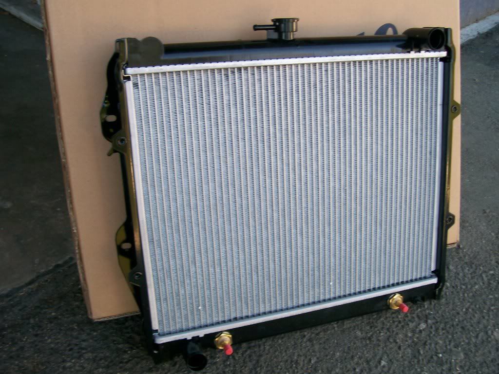

Of all the things I've done to my cars, I have never had to replace a radiator. From my original thread you all know I had a chevy 3 core in there that wouldn't let the hood close all the way. So I found a nice heavy duty, 3 row, aluminum cores, radiator (Found a guy in so Cal with quality rads for decent prices if anyone is interested, PM me). Its metal sides/mounting tabs, plastic top and bottom, but feels pretty solid compared to some of the cheap crap I have seen come off ebay. Lifetime warranty too. I am putting an electric puller fan on there. Should be pretty cool.

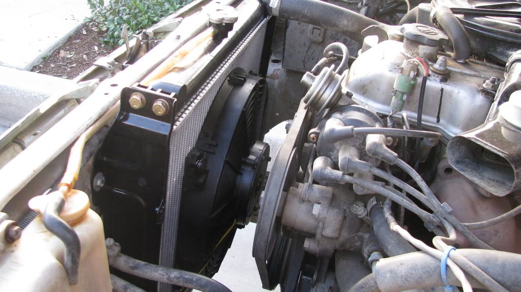

Update: 11/10/08 Thanks all for your help! Got her all installed today, burped like a baby and no issues all day. Radiator alone kept it at about 175 degrees at a stand still, with no fan. Flipped the fan on and she purrs at a steady 145 degrees.

Radiator:

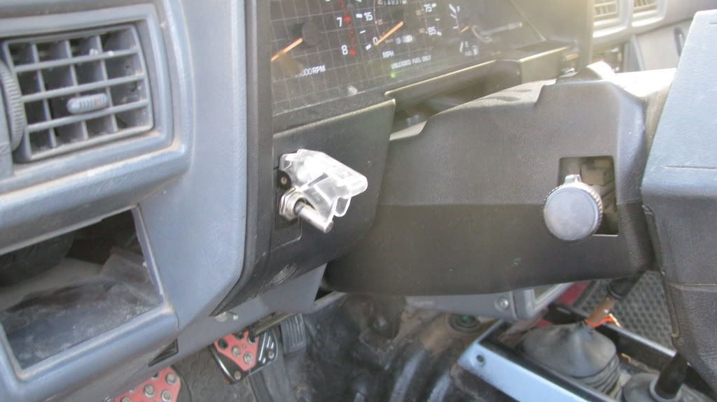

Dummy Switch - Didn't install thermo switch yet. Don't know if I will.
Finally her hood closes all the way. Aint she pertty!?
