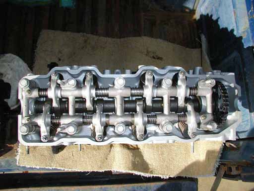

Old Dec 17, 2007 | 03:33 AM
  #30
85BigBlue's Avatar
Joined: Dec 2007
Posts: 9
While you're at it, pull the block too. j/k I would definately not cut corners if you do this and pull the head like mr. willie says. I believe the service manual says to remove the head. I outlined the timing chain guides in red. Typically the left side *driver side* is what fails causing the chain to rattle against timing housing cover eventually grinding a hole into the water jacket. I also included a pic of the overhead cam which is the rod going through the middle. When the crankshaft turns, it turns the timing gear at the top which turns the cam which moves the rocker arms to open/close valves.
You're going to want to remove the oil pan to remove the broken pieces of the timing guide.
You probably skipped a a tooth with the guide broken which would cause the engine to run sluggish. If you want to know if that happened, you can check by just removing the valve cover. Rotate the crankshaft so the knotch on the pulley is at 12 o'clock & lined up to the 0 degree mark of the timing cover. The #1 piston will be at top dead center on either the compression or exhaust stroke. Look at the cam gear. There is a dimple on it. That dimple should be at 12 o'clock. If you don't see the dimple on the cam gear, rotate the crankshaft pulley 360 degrees and line the knotch up again. You should see the dimple now and it if it's not at 12 o'clock, then you skipped a tooth. Before removing the cam gear, rotate the cam so the dimple is at 12 o'clock. Once you have the timing chain exposed, you can replace the guide. Make sure when you put everything back together that the cam gear dimple is at 12 o'clock and the knotch in the crankshaft pulley is lined up at the 0 degree mark on the timing cover so piston #1 is at top dead center (some chains have 2 silver links which are supposed to line up with the dimples on the cam gear and the crankshaft gear).
When you install the distributor, slide in the rotor so it goes in at 12 o'clock. It will rotate counter clockwise and line up to the #1 spark plug. That will get you close enough to get it started. You shouldn't need a light to get the motor running decent, but you will need it to set it to precision. If you don't want to buy a light, rotate the distributor until the enging sounds normal then take it to a shop. It would take them all of 5 minutes if you installed your chain and distriblutor right. I don't know what they charge for that though.
